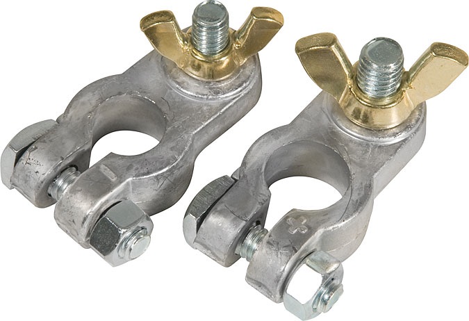

My battery connections need to be replaced because I hate them.
Any other suggestions? I hate the old school soft metal ones...what is that? Lead?
I like the marine ones. Then you just use wing nuts to connect the wires to the battery. It makes it so much easier if you're like me and always working on something . I'll see if I can find a pic.
Here you go. Love them.
