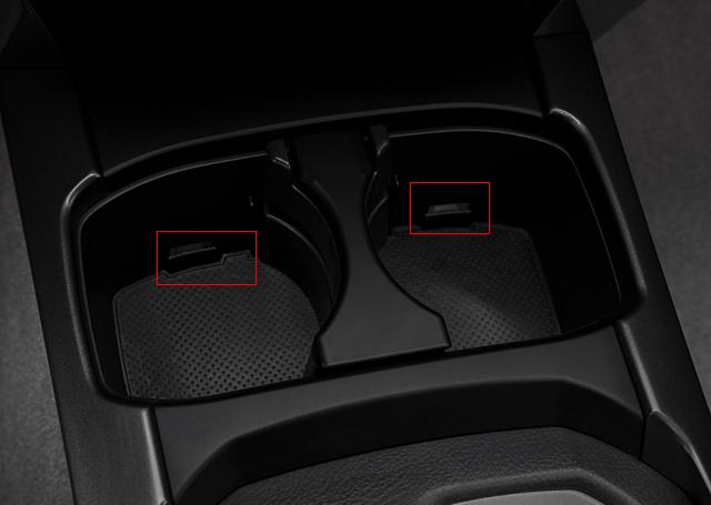

I read a few posts a few weeks back about there being lights in the front cup holders. I looked in mine the other day, and although I see the white/clear squares at the bottom of the cupholders, there doesn't seem to be any light whatsoever coming out of them.
Am I correct in believing that they should be lighted whenever the headlights are turned on, just like the rest of the dash? If so, is there any way to find out the part number for the light, or how difficult it would be to replace? Thanks for any advice!
I believe these are what I think should be lighting up?

It is true that the lights will light when the headlights are activated. As far as the part number I do not know. I am sure that the Toyo dealer would know. To get to those lights, I believe you start by prying up the middle from the center console. There are threads in the forum that will show how to do this carefully. I will try and find the specific thread I am talking about.

Dont mess with the stealership. First check the plug. Mine was unplugged when I first bought my T4r. If that isnt the case the light should be a simple LED, that radioshack or a similar electric dealer can provide for CHEAP!! When I had to replace my back lights in the A/C and 4WD knobs they we just LEDS. I bought 5 of them for $8. Good luck.
Thanks, I'll look at that first. Unfortunately I just got home for Thanksgiving break, and got a ride with someone else, so the 4Runner is back down at school. Guess I'll just wait a week.

Before you take the console apart, have you checked the dimmer? It's very dim unless dimmer is halfway or more.
I always keep my dimmer at the brightest it can be, so I don't believe that is the issue.
Mike, thanks for letting me know, but my cup holders are pitch black right now, so I'm pretty sure it is an issue with the bulb being burned out, or even not plugged in. Guess I have to wait a week to figure it out :-/

My feeling is, it is not the LED lights. They are suppose to last a long time. I can see one going out, but to have both go out, it could happen, but I am thinking it is something else. A loose wire or connection, or something else???

Instead of doing it when I have nothing better to do than watch the ACC debacle, now I'll have to try and figure it out during school. I'll check the connection before doing anything else, wish I didn't have to remove the entire middle console to do that, hopefully it won't be too challenging.

Well, just tried to figure out the problem. Got everything removed that I thought I needed to, but still couldn't get to the lights. All of the plugs seemed secure, I traced the cord going from the back of the cup holder as far as I could until it disappeared into the bottom wires below the shifter. Still couldn't figure out how to get to the lights themselves, and the write up here: http://www.castulucci.com/projects/carpc/oemnaviaccess/ didn't give any explanation on how to get the cup holders themselves out.
I know it's pretty pointless and not a big deal, I just like everything in my cars to be working and get annoyed when it isn't. Hopefully someone else has a suggestion, otherwise I guess I'm SOL:confused:
