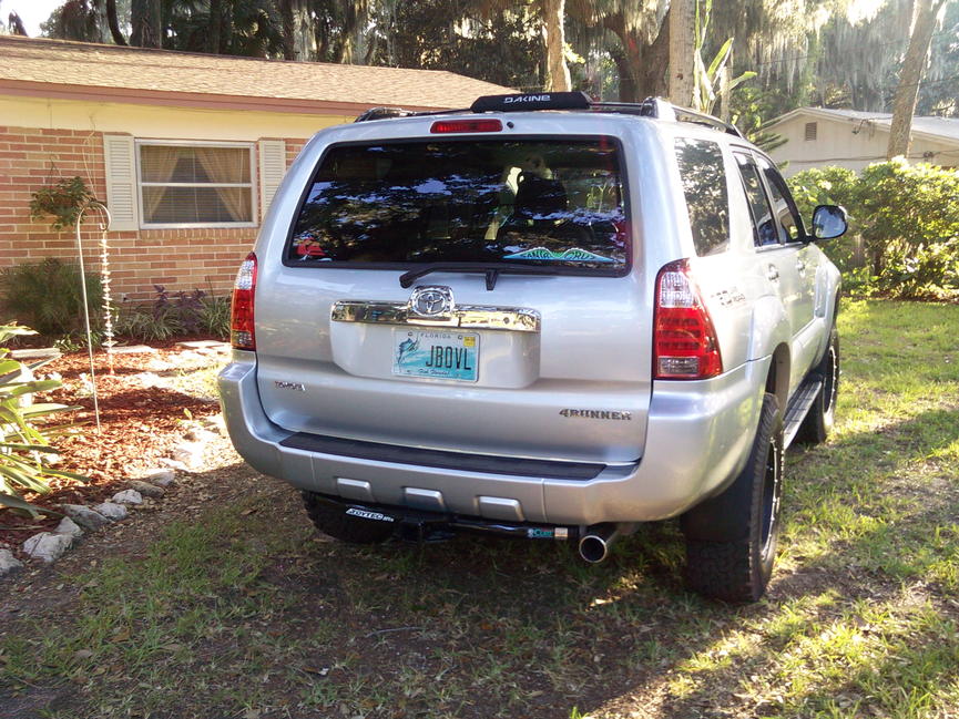

If you zoom in on this picture you will see my Curt hitch, got it about 2 years ago I think? Very nice appearance, I liked it better than the Uhaul styled ones. I used etrailer for this and other items, great service and shipping....I would recommend them.
I was thinking about the hidden hitch but your Curt hitch looks sweet.
I looked at hitches a long time before deciding, and I am happy w/ this one. It has a very clean and nice appearance, plus there is a "little step" on the top part that some don't have. It has held up very well also!
