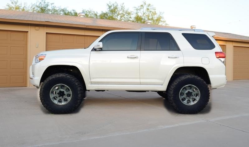

Here's a very quick and dirty photoshop of what it would look like with 3" fender well widening 2" forward and aft axle movement and 37's and 3" lift.
Also thanks for the pic to whoever's white T4R I used. It was the first one Google came up with that was the right profile to make photoshop easy.
For comparison to stock form:

Understood. Contact patch calculations? You might need to factor in the cost of regearing to 4.56.
With that said it would be a very cool mod. I take it this is not your first rodeo lol. Good luck and this mod might just edge out all those "build" threads people recently started to show off their floor mats and window tint! Make sure to post up when you start getting ideas together. There are some seriously talented guys here.
