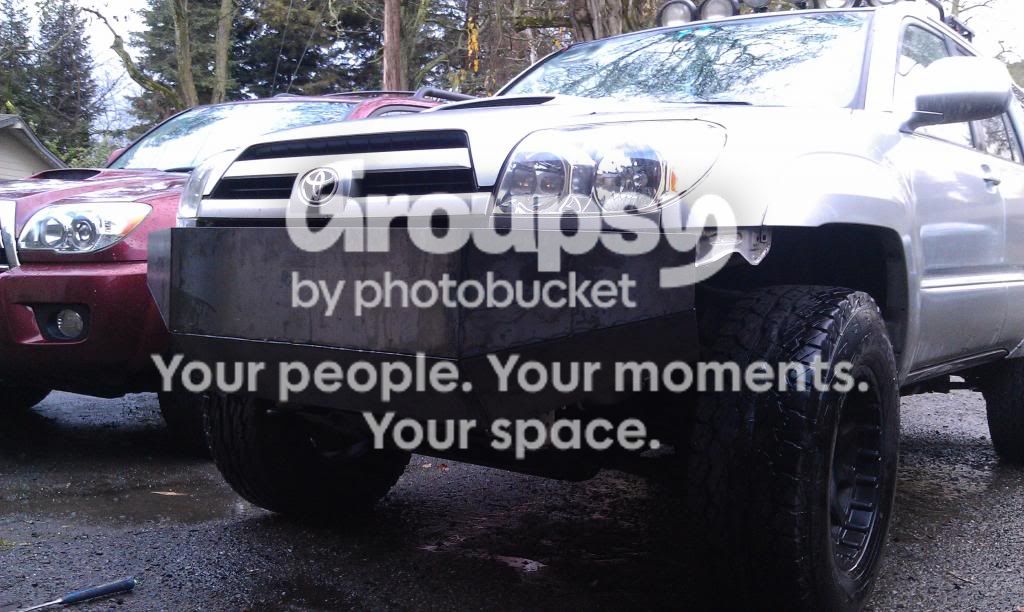

Bumper off
IMAG0515_zps9d9afedd.jpg~original

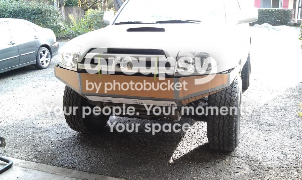

First mock up, too small though
IMAG0514_zpsa0fd6192.jpg~original

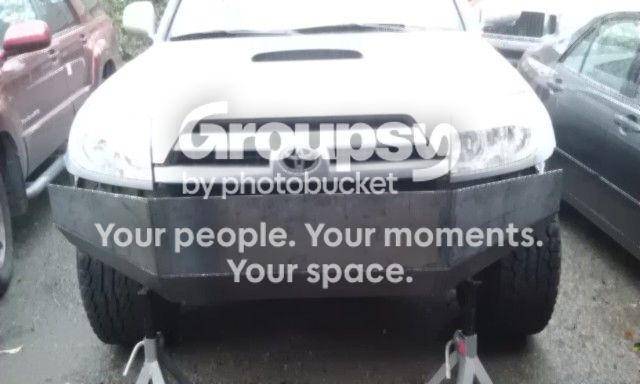

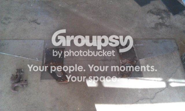

Plate cut, brackets made
IMAG0519_zps08e09c0a.jpg~original

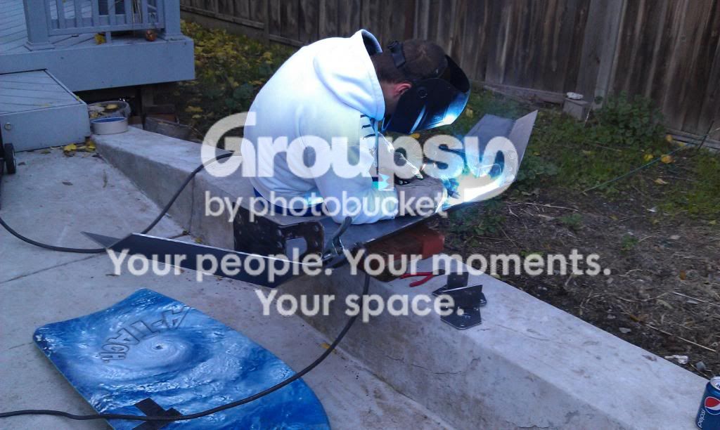

Welding it up
IMAG0521_zps15d93f4e.jpg~original
Coming along nicely
IMAG0520_zps60760781.jpg~original

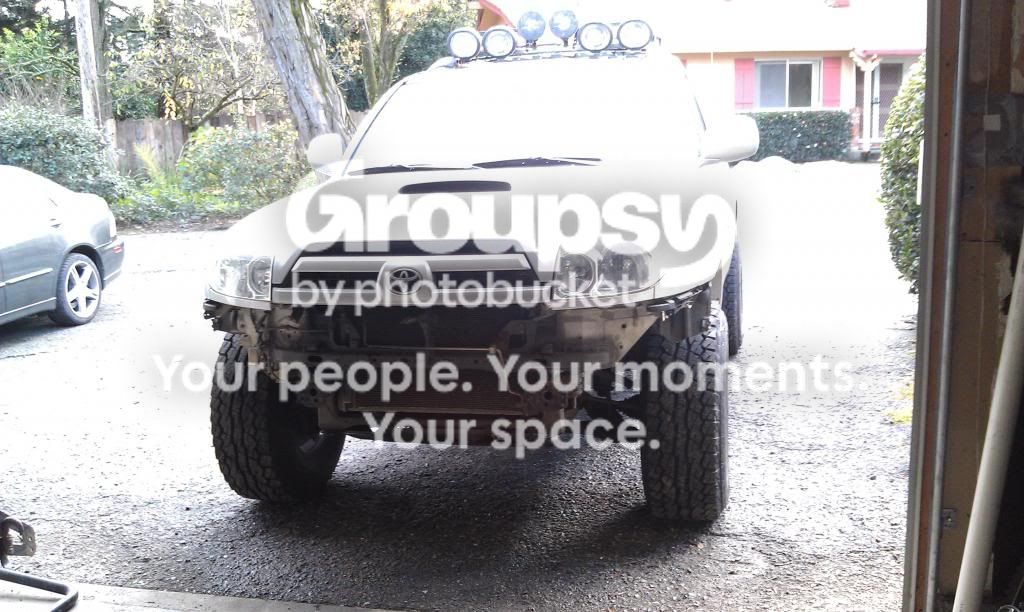

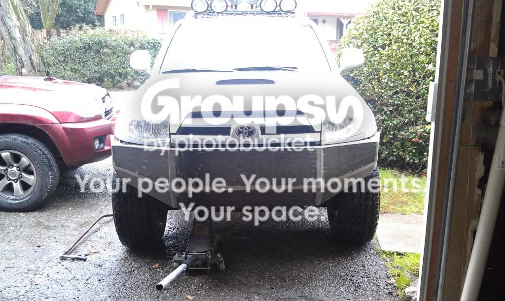

First mock up of steel on car
IMAG0522_zps8de760d9.jpg~original
IMAG0523_zps082ecfe0.jpg~original

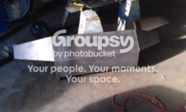

Main section welded, and brackets done, bolted on
IMAG0527_zpsf76e6836.jpg~original

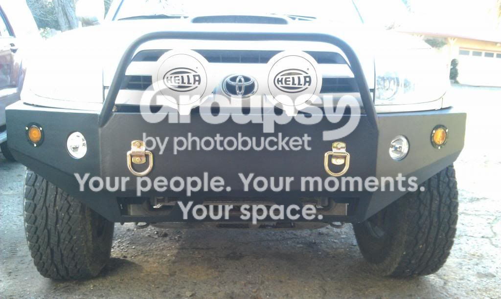

Finished, and painted with bed liner
IMAG0541_zpse8a1c91f.jpg~original

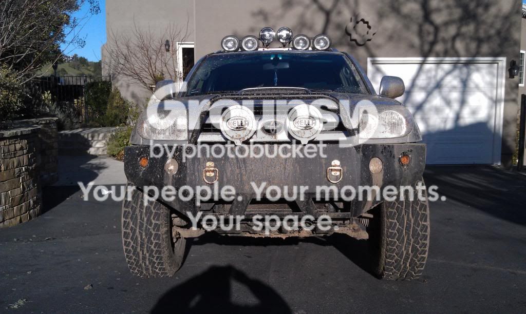

And dirty!
IMAG0549_zps719bd1f6.jpg~original

Oh, man. Please don't ever use those rings for anything more strenuous than lashing a canoe to your rack. Try and recover off of those and if you're lucky they'll pull right out at the first bit of tension on the strap. If you're not lucky they'll hold just long enough to turn into missiles when they do let go, and if it's a really bad day they'll wait until you're halfway out of whatever scrape you were in before tearing out and your truck will fall back into the rock or mud and be in worse shape than before, with bonus body damage.
Recovery points should be rated for a static load at least twice the total weight of your truck, and tied directly back to the frame. Those Home Depot deck loops aren't going to cut it, and even if they were strong enough by themselves they'd taco your bumper because you don't have them tied into the frame.
I like the bumper, it looks good. But please take those loops off before somebody gets tempted to try to use them.
I know they may not look like much, but they aren't just homedepot rings bolted to the plate steel. What I didn't show pics of was the reinforcement tube steel I put going from frame end to frame end to prevent the frame getting bent inwards. I also have a pretty hefty structure behind all the plate steel to prevent it from tacoing in. The rings themselves are rated for 12,000lbs. On the back side of where they mount is roughly a 8"x10" 1/4" plate welded behind where they mount to thicken the plate up. It is also gusseting in the the side brackets that make up the shape of the bumper, which are directly tied into the frame rails. Right now the only weak point is the bolts. I have yet to find any higher rated bolts locally, so I just have grade 8's in there now. I appreciate your concern but I put a pretty serious amount of thought into everything I did. I'm studying to be a mechanical engineer, so I live for this kind of thing.
