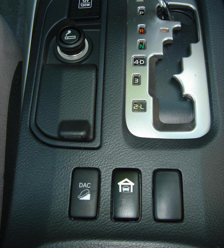

I don't have the homelink buttons in my overhead panel, so I recently installed a custom garage door opener button in my center console.
I started by purchasing a second OEM "VSC OFF" button (the one with the car glyph, with skid marks, and the word "OFF"), wiring socket, and "repair" wires (wires that already have the metal connectors on the end, which slip into the "socket"). The "VSC OFF" button is a momentary switch.
Then I masked off the car glyph (and the body of the button), and sprayed flat black model paint over the button (a few coats), to get rid of the skid marks and "OFF" letters.
Next, I removed the masking tape from the car glyph, and rubbed on some dry-transfer decals to make the garage outline glyph. I wish these had been a little narrower, and I still may redo it if I find the right decals.
Finally, I sprayed a few coats of semi-gloss ModelMasters lacquer over the whole button surface to make a good match for the OEM buttons and to lock in the dry-transfer decals.
Installation consisted of connecting two wires to tap into the ashtray illumination wires (could have also used the DAC switch's illumination wires), one wire to constant 12v power (my power socket is constant, having done the constant 12V power outlets mod), and the last wire I ran up thru the dash, up the A pillar, under the headliner, to the cavity behind the overhead (maplight) panel.
That's where I hid my garage door opener. It's a 12 volt LiftMaster unit. I soldered the internal switch contacts, and ran the last wire to the + terminal where the battery usually sits. The - terminal has a wire soldered that taps into the ground wire in the overhead (maplight) panel. I used a Deutsch DTM 2-way connector for modularity.
I used "Posi-Taps" for the tapped-in wires. They are much better and easier to use than "vampire" taps.
At night, with the parking lights on, the little car glyph is illuminated!

I'm not exactly sure which wire you're asking about, so let me try to explain the entire path of power to the garage door opener:
Posi-tap to the hot wire for the 12v power outlet. This is the outlet right next to the gear shifter, under the center console. I ran a wire from this Posi-tap to one of the center pins of the new button. (Since the power outlet is already fused, I didn't install any other fuses.)
Then I ran another wire from the other center pin of the new button, down along the wiring harness that's already in the center console, behind the dash, then left over to the A pillar, up the A pillar, under the headliner, to one pin of a 2-contact Deutsch DTM connector which lives in the cavity right above the overhead (maplight) panel. (The other pin of the DTM connector runs to a wire that taps into the ground wire for the maplight assembly.)
A matching, opposite gender Deutsch DTM connector is connected to the two wires going to the garage door opener (which are soldered into the opener's circuit board).
I know, I should've taken some pictures. If this explanation doesn't make sense, let me know and I'll open it back up again and snap a few pictures.

Sorry, I didn't take any pictures of the soldering of the garage door opener switch contacts. When you open up the Liftmaster unit (I'm sure they're all like this), you can see that the buttons just push down on these little board-mount buttons. Those board-mount buttons always just connect two of their four mounting pins when pushed, so you just get an ohm meter to see which two pins to use. In this case, I soldered those two pins together (one the back side of the circuit board), as if the button was always pushed.
I soldered in the wire that comes from the new center-console button to where the positive terminal of the Liftmaster battery touches, and soldered another wire from ground to where the negative terminal of the Liftmaster battery goes.
^^ Sorry, I don't recall. I think I remember there being 4 pins: illumination, ground, and two contact pins. Since it's the same as the VSC button, the pinouts are the same, if you can find a spec for that button in the wiring diagrams. Or you could use an ohm meter to find the pins.
