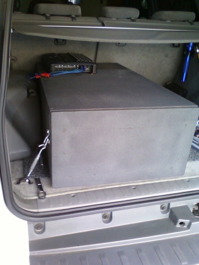

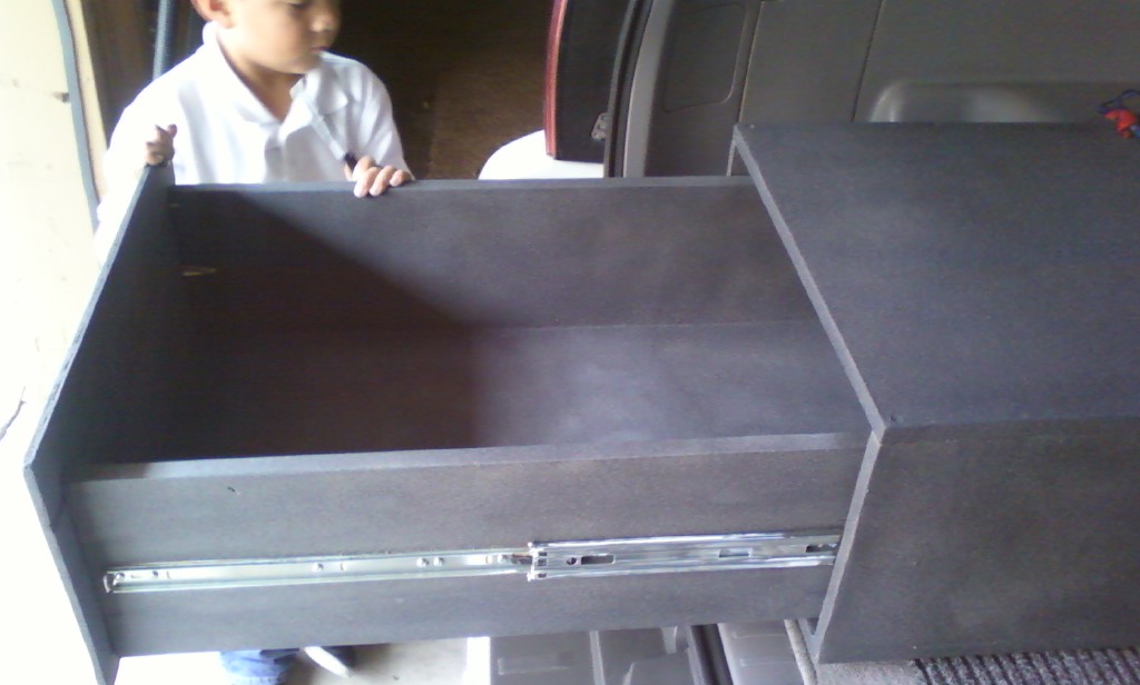

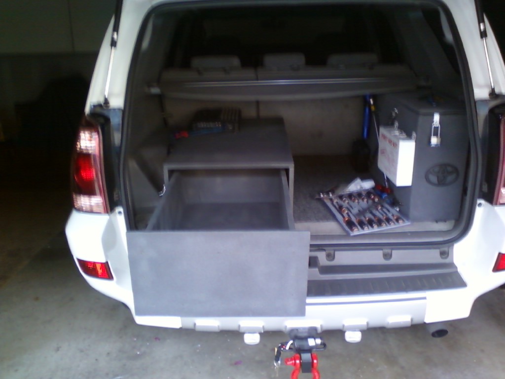

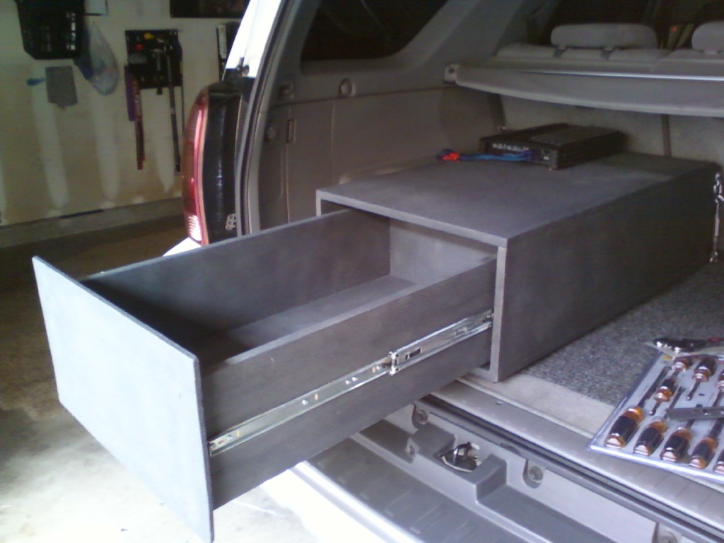

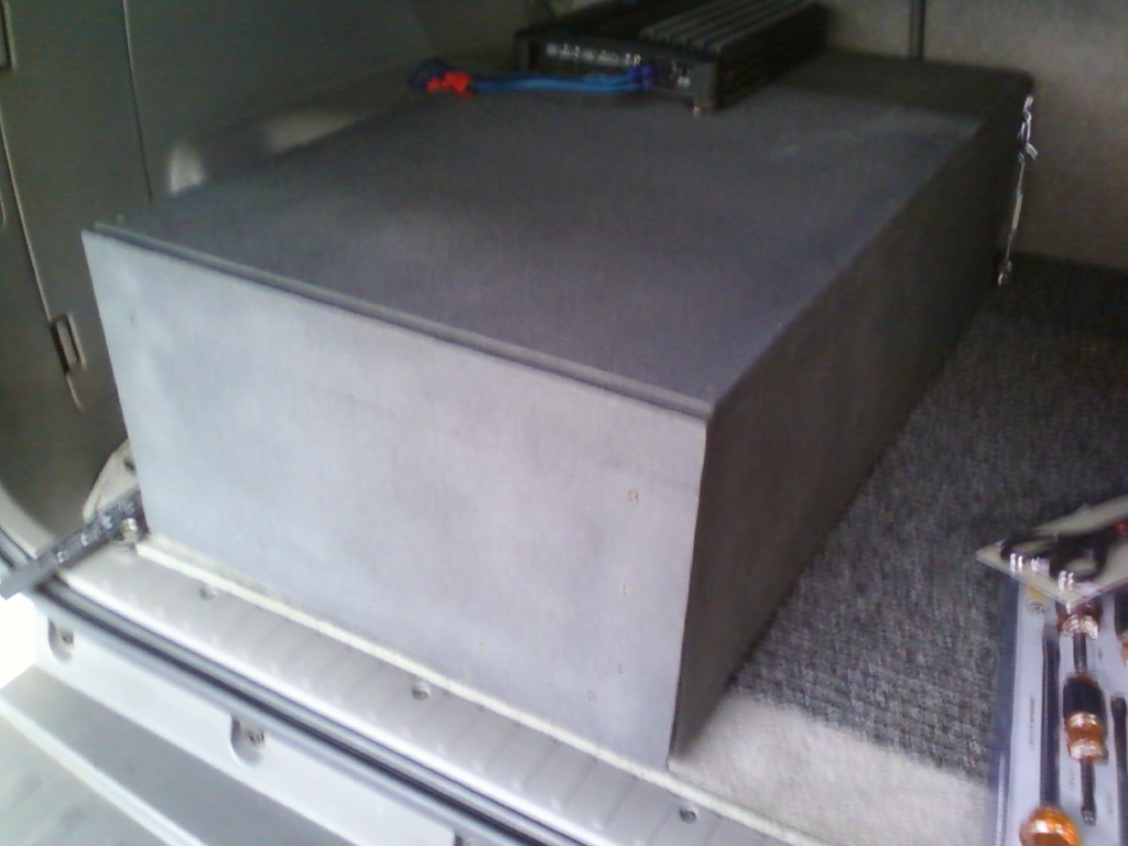

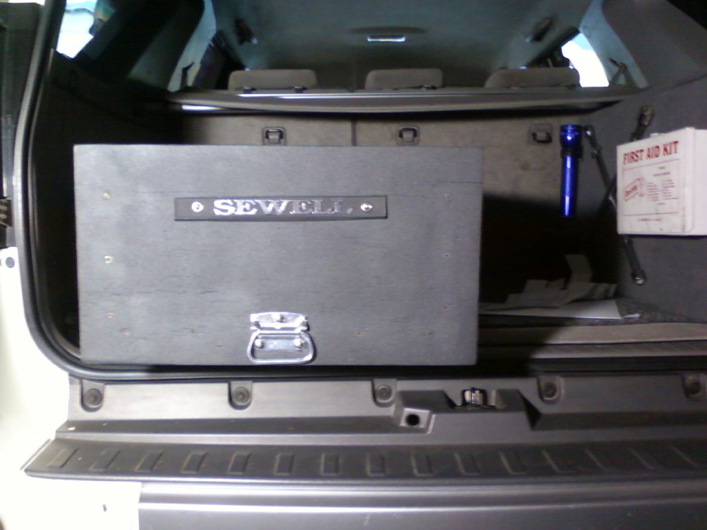

Figured I would add the newest photo of the box I made. Found a license plate frame in the middle of the road with my name on it so I cleaned it up, painted it then mounted it. Also added a handle about 10 minutes ago.
Well I have been looking at making this for quite a while now but just could not figure out how I wanted it to be configured. After some thought and plenty of wood in the garage, I came up with this puppy.
Once I got going on it, the box kind of took on it's own measurements and went together fairly easy.
It is held down in 3 spots, 2 of which are shackles and the 3rd is behind the amp. I used a 3" bolt and went into the threaded hole that held the factory tiedown hook. I did place the hook back on the top of the base on the box so that I would not lose it's use.
I used 2 coats of KILZ primer on the entire box then sparyed it with 7, yes 7 cans of RUST-OLEUM MULTI COLORED TEXTURED spary paint in the AGED IRON color.
This stuff was a bear to spray, as it's mostly grit. Pretty close to 200-250 grit sand paper. It's not too rough and not too smooth either.

thanks killer.
there is actually about 3/4" at the bottom of the face that i used to pull it out with. I would like to add a handle but can find the one that catches my eye just yet.

i have plenty of room still. i can even get 2 of my dirt bikes in the space left. i checked when i made the box.
it just seems as though people think that if you are build a box that it has to be the same size as the seat that it is next to.

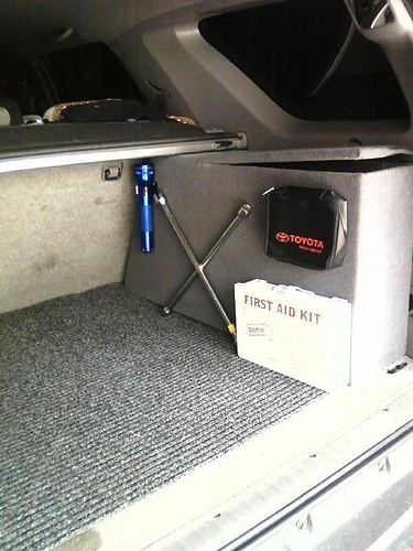

thanks guys. i actaully have two boxes. 1st one is where the JBL sub would be and stands vertical. it has the jumper cables, ponchos, air pump, straps, rope, solar panel and some other misc. items in it. I also have the 4 way mounted to it with a 1st aid kit and my maglite. I am a rope and duct tape freak so most likely the vertical one will consist of just that and everything else will mover over to the new box as well as some MRE's, water packs, blankets and some tools. here's a pic of the vertical box. it's open because i was seeing how much stuff i could cram in it but it does close and lock.

I noticed it as well in the other photo's and liked the Toyota emblem, nice touch.... is that made out of wood?
I also like the idea of the flash light and 4-way (which I need to transfer back over from my trailer) mounted for easy access.
hey ridger. yes, it is made of 1/2" plywood. Having the light and 4way there saves me from having to find a home for them elsewhere. It's nice to be able to just reach in a grab what ya need in a split second. The little toyota 1st aid kit is full of batteries new in their case. I keep alot of 9v's so that I can make a fire by putting them and some really good steel wool together, thus making a short circuit and overheating the wool. All that ='s fire.
