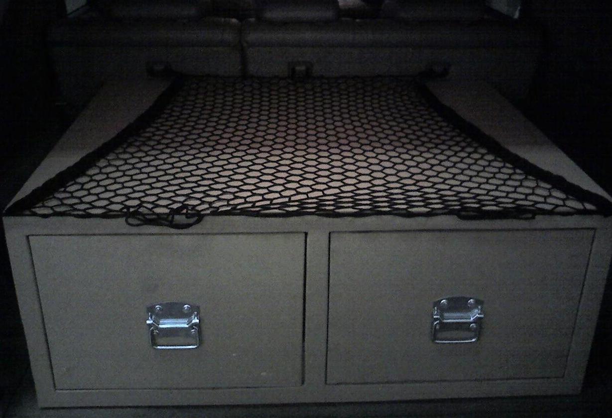

Well after finish this project around the same time Virginia Tech won the Orange Bowl, here is the final product. If you would like more detailed pictures don't hesitate to ask. I have almost 50 and can email them or something to you guys.
The materials used were;
2 sheets of 3/4x49''x39'' MDF board. 1 1/2'' finish nails. Wood glue. 3'' handles, 9/16'' drawer lock, and Heavy duty 100lbs. capacity drawer slides.

kinnakeettom said:
Built basically the same setup, you need to add locks to prevent the drawers from sliding back into the rear hatch
Yeah they are on there now. I tried to take a picture with them installed but it was too dark in the garage this evening.
I'm not sure what to cover it with. Any ideas...???
Great work!
Super clean looking. What kind of locks did you add? I would love to make one of these to protect my photo gear.
I wonder how much lighter/heavier an all steel enclosure with carpet would be? Wish I knew how to weld.

The locks are 5/8'' drawer locks found in the door section of Home Depot. To be honest, they aren't the best. I just broke one today. Any better ideas for locks that won't break? A metal box would be best but can weigh a lot. If metal is what you want I would go with aluminum as it won't be as heavy. Mine probably weighs in at 150 or 200 pounds unloaded.
