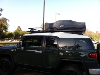

I saw an ARB today at HD that had that look: room for a RTT but with a small basket over the sunroof. I took pictures and will upload them in a bit.

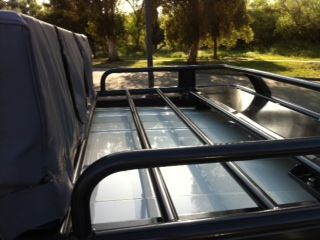

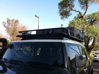

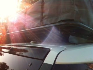

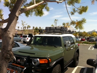

Pictures of ARB rack for reference
Here's one showing the flat back area with a basket up front. Bars cross over the sunroof area, but it's still accessible. Room for lights up front, but probably couldn't fit jack on the side. Maybe a shovel.

looks good, and very buildable. i think gobi uses rubber padded stands for the front of their 3rd gen rack since theres no other way to support the very front, which i guess is ok i just hate stuff touching paint.
