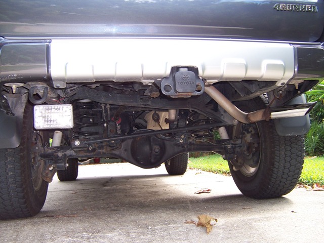

I did this mod the 2nd month I had the rig. Added a Flowmaster, cut out the rez and put the chrome tip off to the side.
