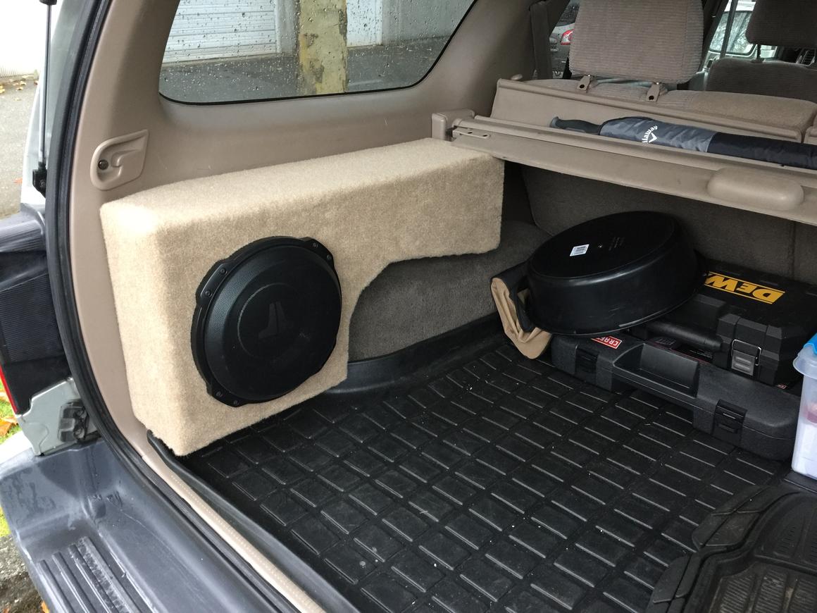

Heres what i did...
Custom box on driver side, carpeted, sealed, and anchored through the inside to the sheet metal just behind the side panelling.
1 - 10" Slimline JL Subwoofer (more than enough, and JL i highly reccommend)
Custom made to:
- The right air volume required
- Low enough that the tonneau cover still goes over if need be
- Hight enough that the trunk liner tray can still utilize the raised edge without cutting and can be lifted in and out.
Personally i reccommend a similar set up as you dont lose trunk space really (width of rear hatch access) and better yet it retains having that storage compartment on the rear passenger side. Always handy to have.
