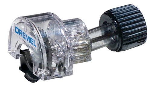

I used the Dremel 670 Mini Saw Attachment with 4.1 out of 5 stars on Amazon - Price:$19.60
It worked fine with clean cuts and then I sanded a couple of rough areas and it looked factory.

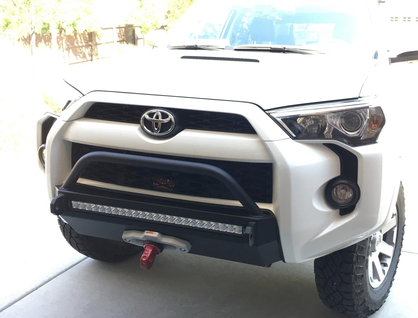

What size light bar fits in that cutout?
It is a 30-inch single row Hausse LED lightbar that was one of the options on the Southern Style Slimline bumper group buy held in the early summer. It works OK, as I didn't really need one as didn't think I would use it often, but it was only around $200 after the discount so I thought why not. I like the look and it is handy off-road as the sun begins to fall below the mountains early this time of year on the trails.
