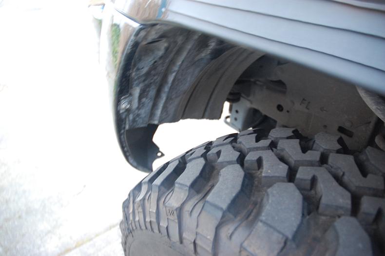

I am about to order my 35s and I was wondering if anyone has pictures to show how they the the front fender and what it looks like thanks
Best way to trim is by trail and error. Start off conservative and get more aggressive with your trimming. It depends on your specific tire, wheel offset, alignment etc... Also you will need to (if you have not already) cut your body mounts, add extensions to your steering stops, add bumpstop extensions, trimming away from your firewall, hammer down the pinchweld on the firewall etc...
This is only the fender liner, but gives you an idea....
