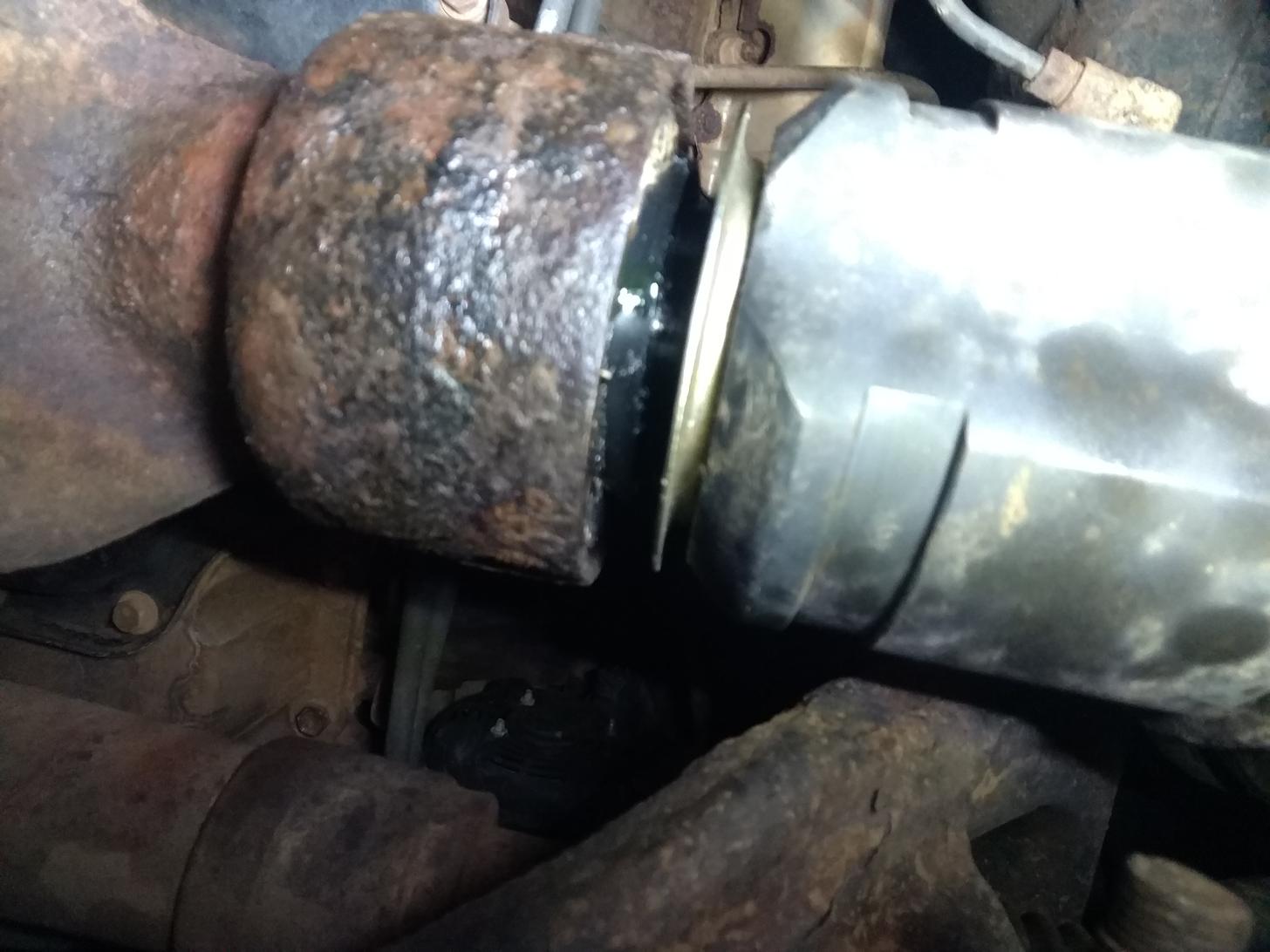

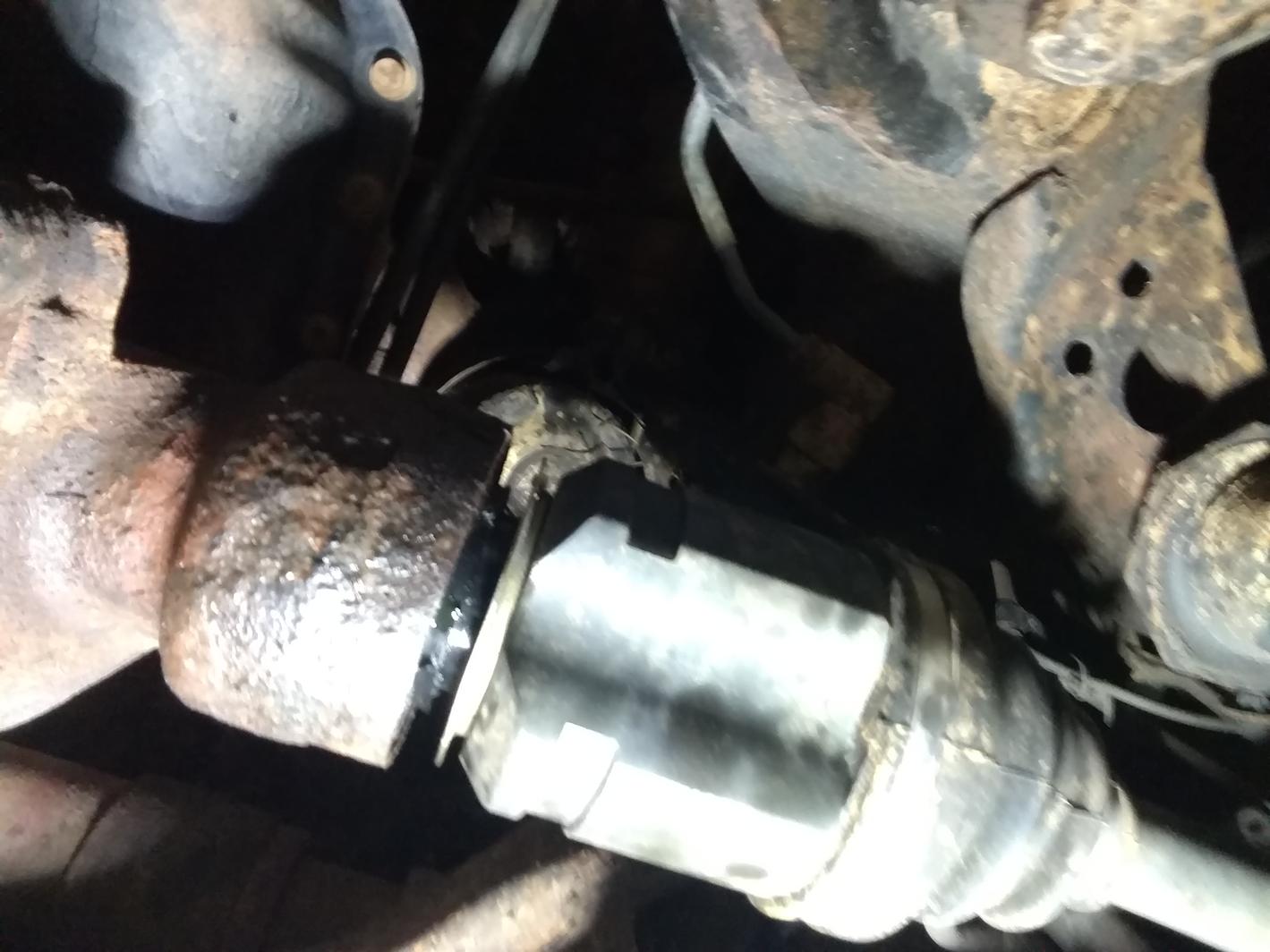

Found a oil leak on driveway today. Is this a CV axle gasket leak?

Yes there are 2 different seals for the CV's I'll post a pic. The top two are them, the "thicker" one is the passenger side (it has a wider flange).
BTW, the other 2 things are the knuckle seals which are on the inside of the steering knuckle, in case you ever need those part numbers. Some guys have had those tear when removing an axle for replacement or re-booting.

Another thing. In your pic, the axle looks like it's not far enough in the differential. That will cause a leak. here is a pic of how it should look.
It's the other side, but both of those dust shrouds should look similar when installed.
