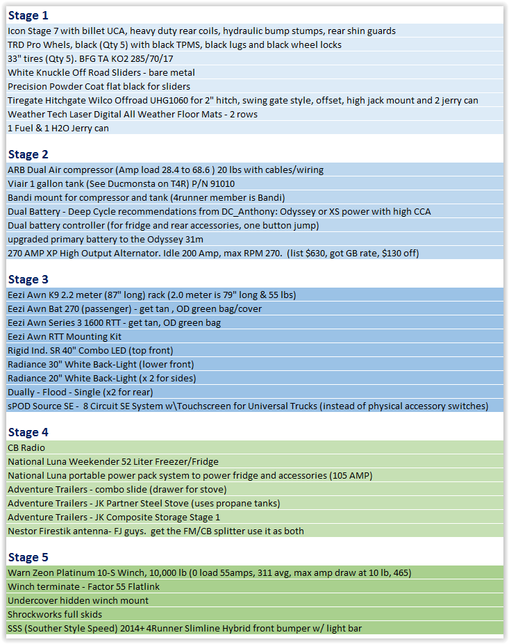

Cytronus Planned Build Stages
Here is a list of planned mods for the build broken out in stages. Things may deviate a bit depending on logic as I go.

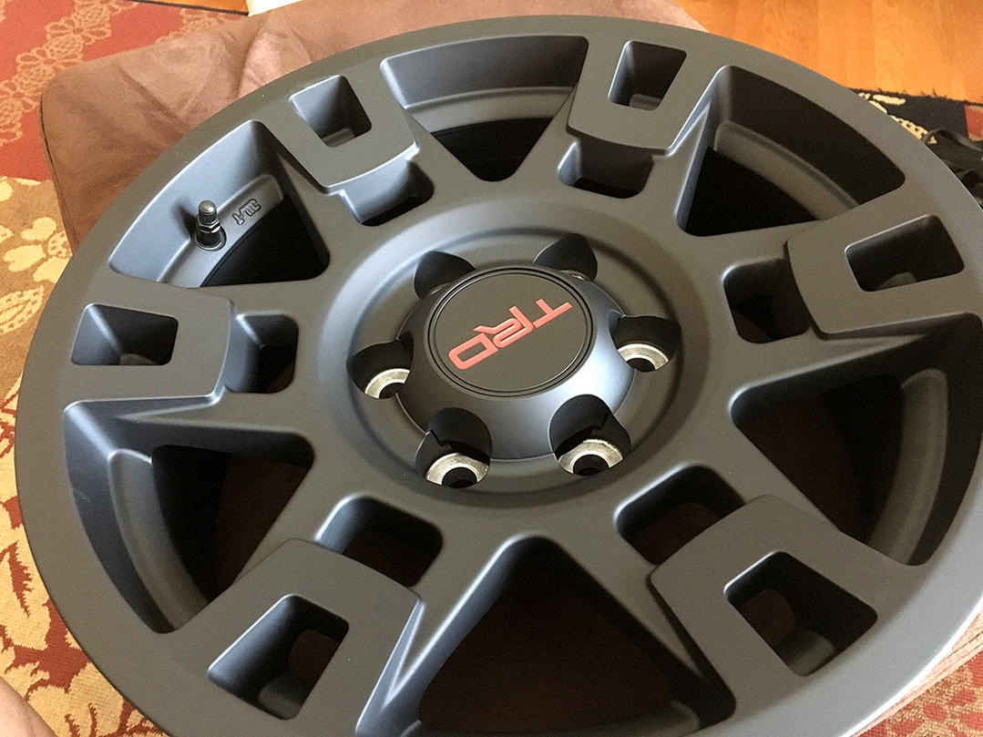

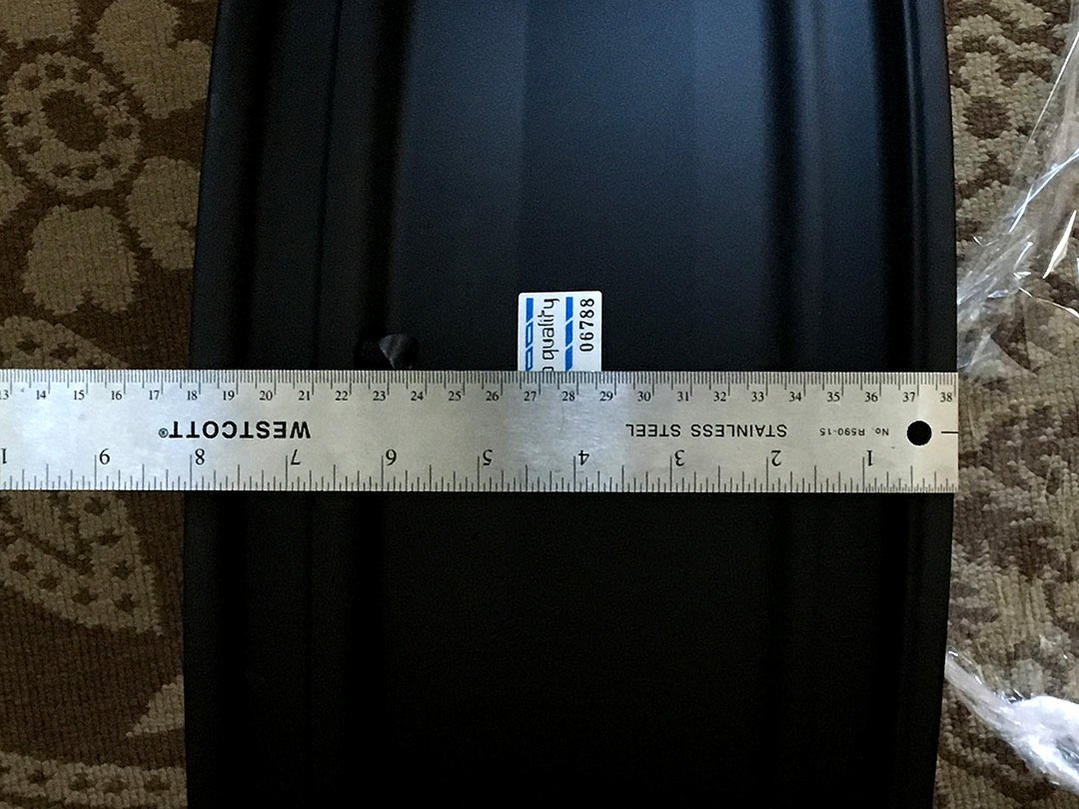

TRD Pro Wheels in Matte Black w/ Black TPMS, Lugs and Locks
I've received 5 new TRD Pro 17x7 inch wheels in matte black, along with 5 flat black TPMS valve stems, ordered from eBay via description: "31 Inc 17-43018 TPMS Programmable Smart Sensor BLACK ALUMINUM REPLACEMENT STEM". They are not Toyota specific but they do fit the rim nicely. I'm not sure if the TPMS sensor that mounts inside the rim will actually fit yet but I'm assuming they will. I will order a new set of sensors to be programmed to the vehicle.
Also ordered black chrome lugs and wheel locks from Wheeler's Off-Road. Unfortunately, after hours of searching, I could not find matte or flat black lugs & locks but it should still look mean with the wheels all blacked out.
The TRD Pro rims are 7" in width, as measured correctly from inside lip to inside lip, where the tire meets the rim. The overall rim width is a hair over 8".
Many ask why Toyota went with the narrower 7" wheel on the TRD Pro vs. the wider 7.5" Trail wheel. It was primarily to reduce weight and friction and improve fuel economy, compensating for the vehicle's larger stock tires with heavier tread and added suspension weight relative to the other models. The goal was to keep advertised MPG the same across the 4Runner line up. I would've loved to have these TRD Pro wheels in a 7.5" though.

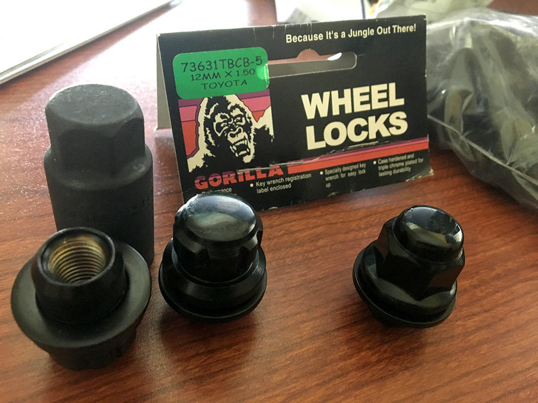

Black Lugs and Black Wheel Locks for 5th Gen 4Runner TRD Pro wheels
Here are the Gorilla black lugs and wheel locks from Wheeler's Off-Road for the 2016 TRD Pro matte black wheels.

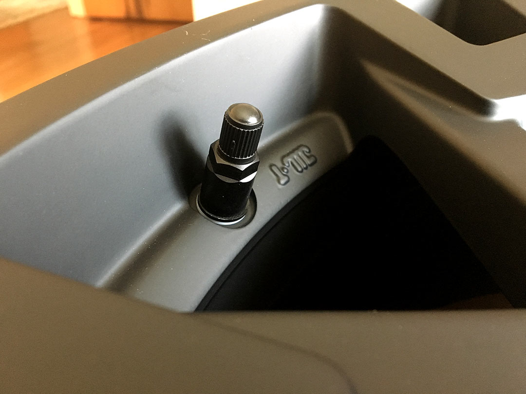

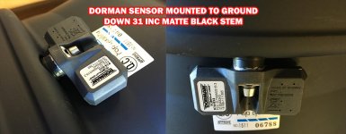

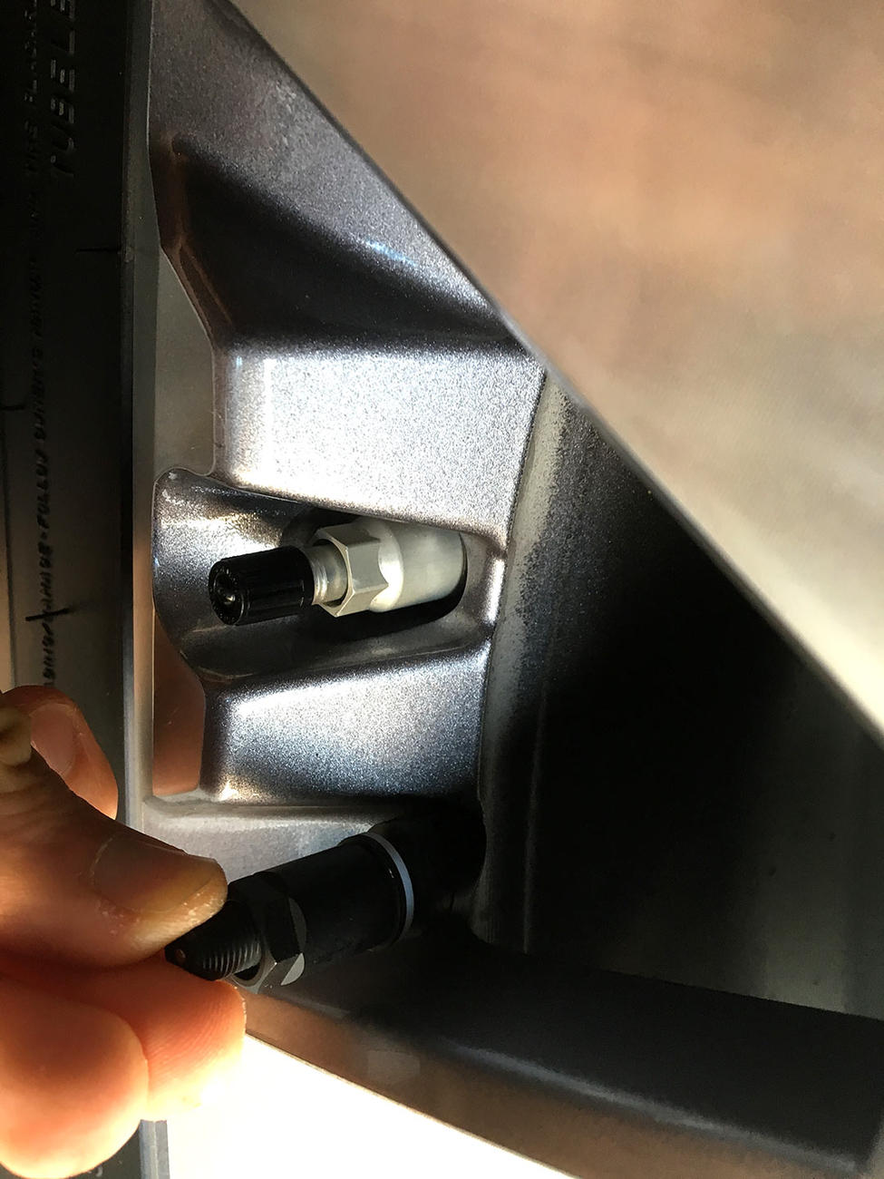

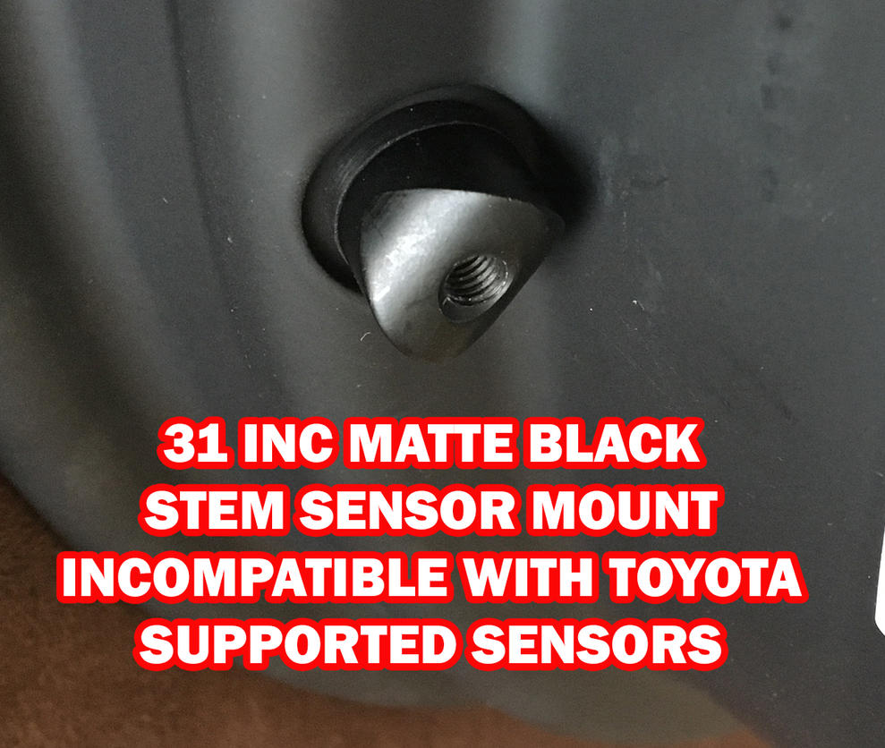

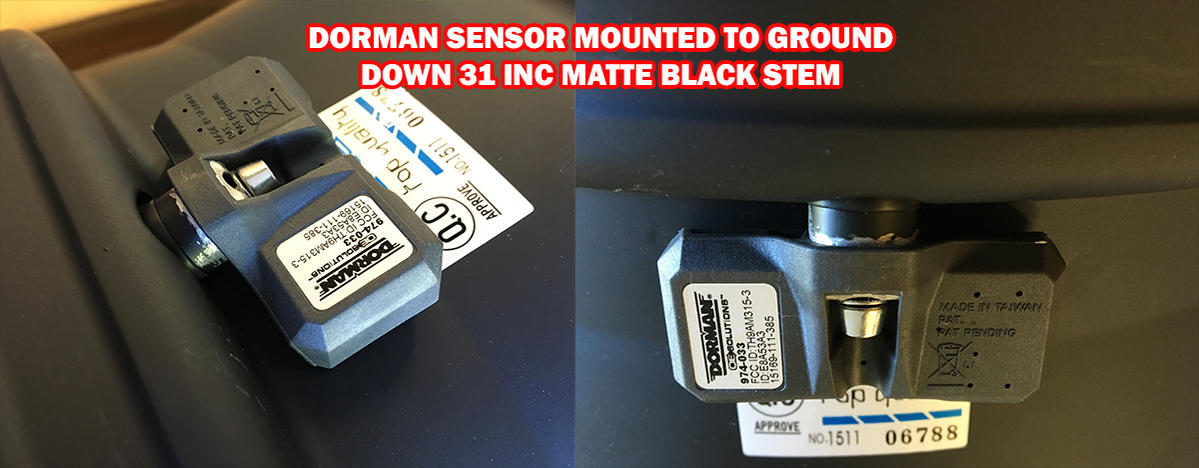

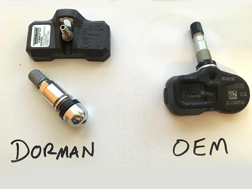

Valve stem update
It turns out the beautiful matte black valve stems I bought will not work with the eOEM TPMS sensors. The OEM TPMS come permanently mounted to the valve stem - they are not detachable from one another as most others out there are.
I ordered the next best thing, a replacement part by Dorman that's about $20 cheaper per unit than OEM and has the sensor that can unscrew from the valve stem. It's a polished aluminum stem with stem sleeve. I will be taking both the OEM unit and the Dorman TPMS part to an anondizer/powder coater this weekend to see what they can do with both. If they can paint the OEM matte black without affecting the sensor itself (since it's permanently attached), then I'll go that route. The goal is to have the paint bond extremely well so as not to chip too easily over time.
I'm fairly confident the dealer or 3rd party shop with a proper TPMS programmer could get either one working just the same.

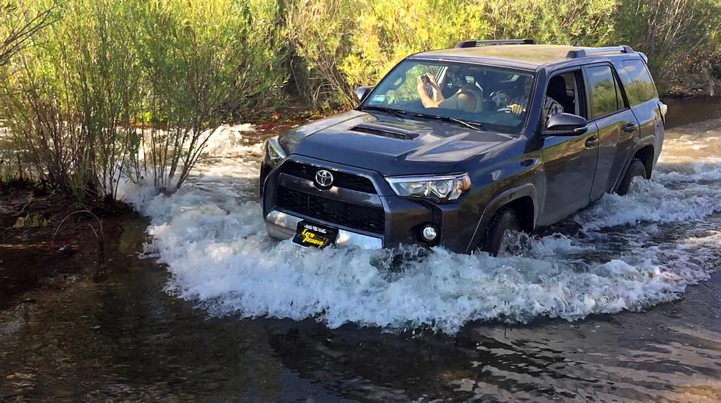

Range Rover vs. 4Runner
The off road highlight of this trip was a versus moment against a stock Range Rover crossing a stream with a water level above the lower door seals.
As we set up camp along the bank of a babbling stream, I noticed a silver Range Rover approaching from the opposite side. He stopped just shy of the edge and got out to survey the potential for crossing safely. I yelled out sportingly, "hey if you do it, I'll do it too!" He replied, "oh yeah, with what?" "A stock 4Runner....a cheap ass Toyota." I hollered back, my ride just out of site behind some shrubs. He chuckled with a sliver of confidence and a hint of concern on his face. He had a female passenger with him and no doubt had to prove his boulevard beast could do much more than a Toyota.
He dipped his front wheels in. I walked to the waters edge, capturing the whole thing on video, attempting to guide him to the best line until he gave up after 6 in-and-outs, afraid of water entering the cabin. He turned around and drove away. We all laughed. But not 30 minutes later, unable to find an easier way to cross elsewhere, he returned for one more crack at it. This time, after 2 in-and-outs, he went for it and made the crossing. I congratulated him as he came up our side and Air Dropped the crossing video to his iPhone, his ear-to-ear grin evident of the relief that his pride and vehicle were luckily still in tact, especially in sight of his girl.
The Range Rover driver then hurled out, "okay let's see what you got!". Without hesitation, I jumped in the 4Runner with a buddy, cell phones all around capturing the drama and I gunned it across the stream with ease, hit the shore, turned around and came on right back. It turned out, water didn't enter either vehicle. Smerking, the guy said "awesome!", thanked us for the fun, video sharing and took off. We later caught up with him at the lake shore, where I snapped a face off photo to post here on T4R to exaggerate the fun of the moment.
More soon!
thanks for the info, nice pics btw
is there not a sensor that can be used with the 31inc black stems you purchase? or just more expensive that way?
sorry i don't know much about TPMS

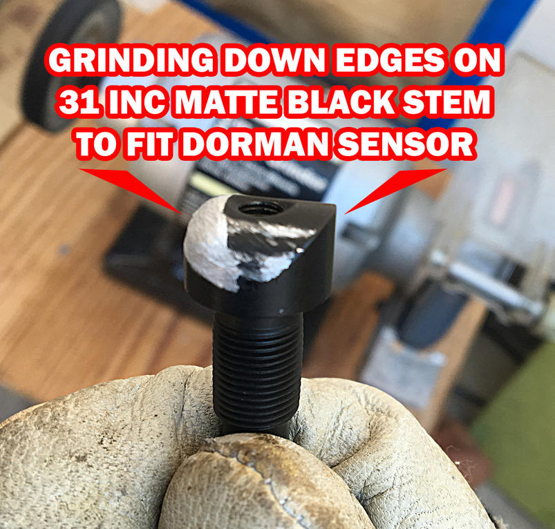

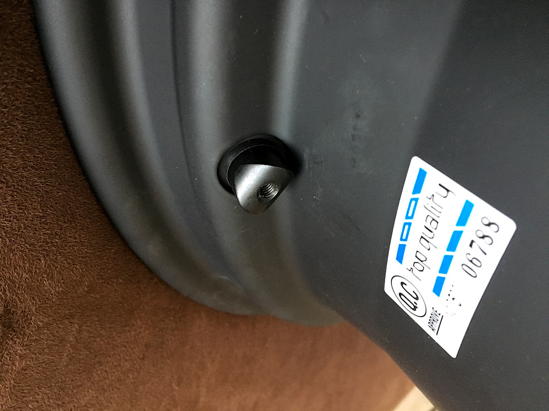

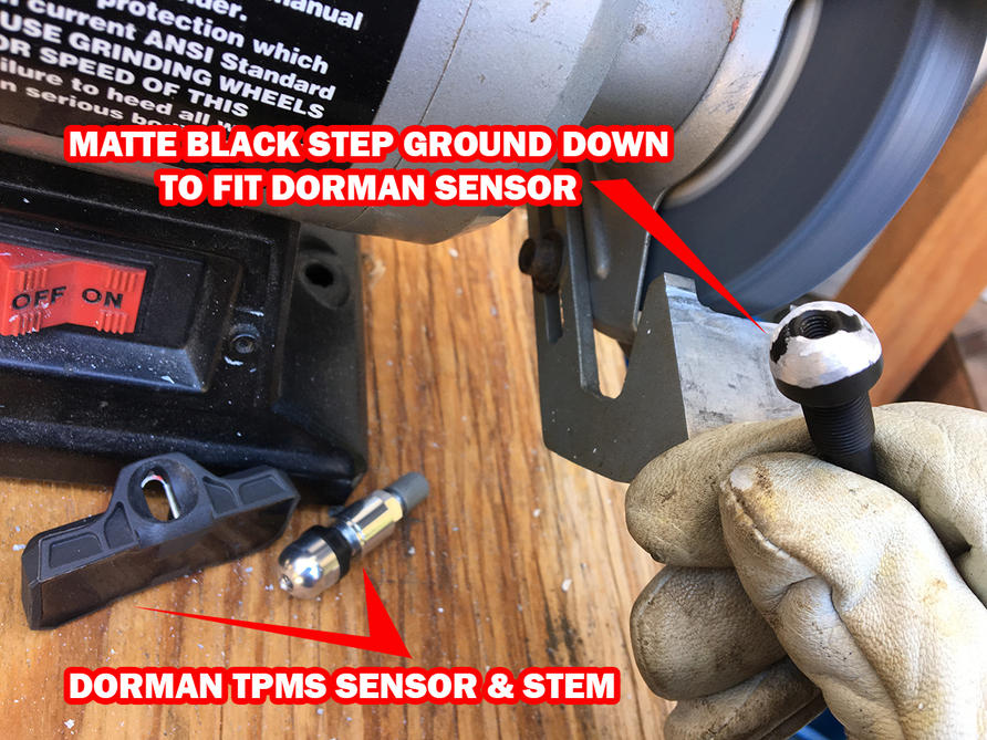

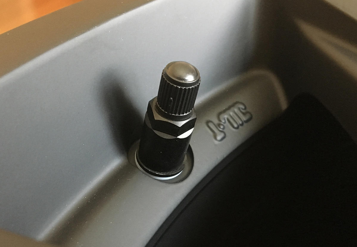

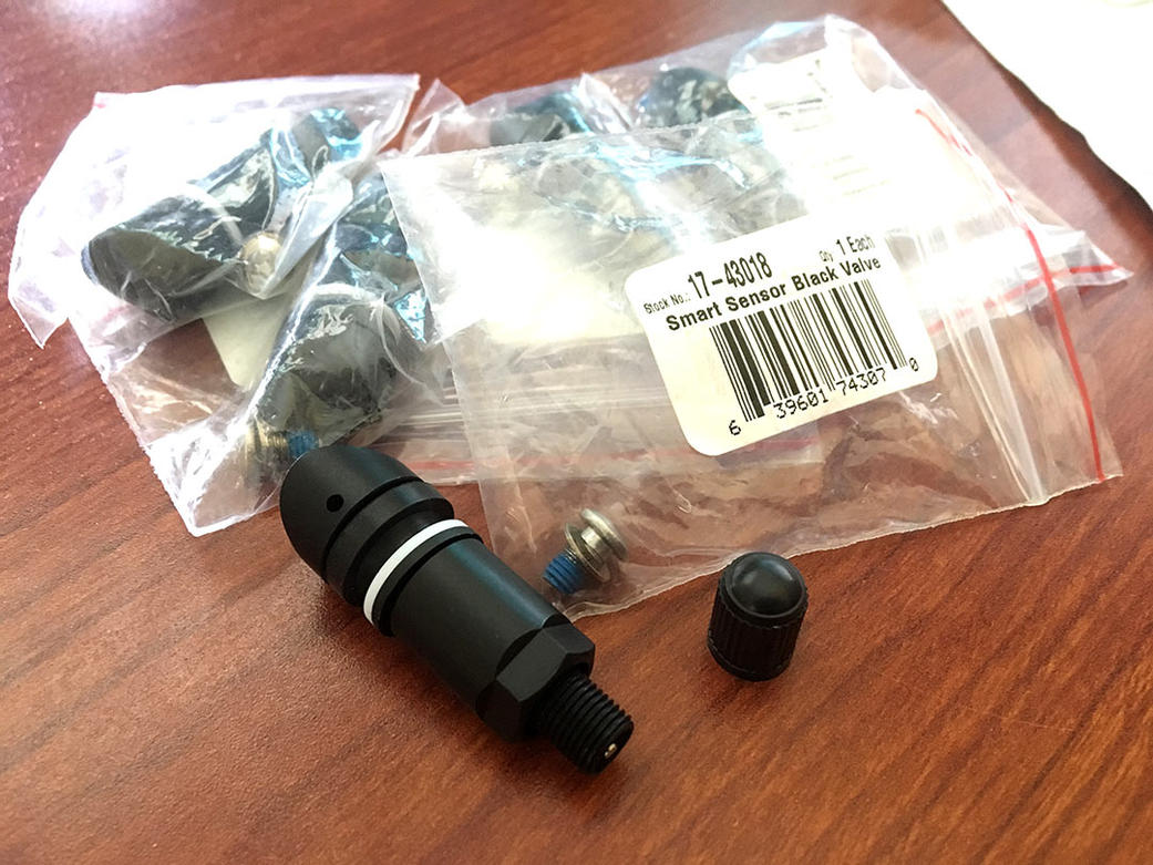

Matte Black Valve Stem Saga Continued
Not wanting to spend any more time and money on the TRD Pro wheel matching matte black valve stem project, I decided to grind down my already purchased 31 INC matte black valve stems (which I believe are designed for BMWs), to force them to fit the after market Toyota-compatible Dorman TPMS sensors. Unlike the Toyota OEM TPMS and stem which are permanently fused together, the Dorman stem and sensor can be separated via ball head stem and screw. I simply ground down the edges of the matte black stems to make them rounded to fit into the Dorman sensor.
Why did I do this? The factory matte black 31 INC valve stems are electrostatically painted, meaning the paint was applied via an electrical bond, which means it will adhere to the metal permanently and resist scratching and chipping that would occur if I were to paint raw aluminum valve stems matte black. I want to do everything right to keep the rig looking cherry as long as possible.
Lastly, for anyone attempting this, if you use a grinding wheel, the aluminum will melt and coat the surface of your grinding wheel, rendering the grinder fairly useless quickly. You just get bumps and skips instead of grinding. You'll need a very hard piece of scrap steel handy to briefly "clean" the grinding wheel at frequent intervals. When done, use a drill with a steel wire brush wheel spinning in opposite direction to the grinder and give it a few minutes to fully clean the clumpy aluminum bits off the grinder.
I recommend these parts if you want your valve stems to perfectly match your matte black TRD Pro or other matte black rims.
Total time: 30 minutes and done.
IMPORTANT! Take photos of each TPMS sensor, making sure to capture the unique ID and FCC numbers of each sensor before your tires go on. Note which number is associated with which wheel as the techs will need these numbers for programming. For Toyota OEM, the dealership generally won't need the numbers but for non-OEM/aftermarket, they will need those numbers.
