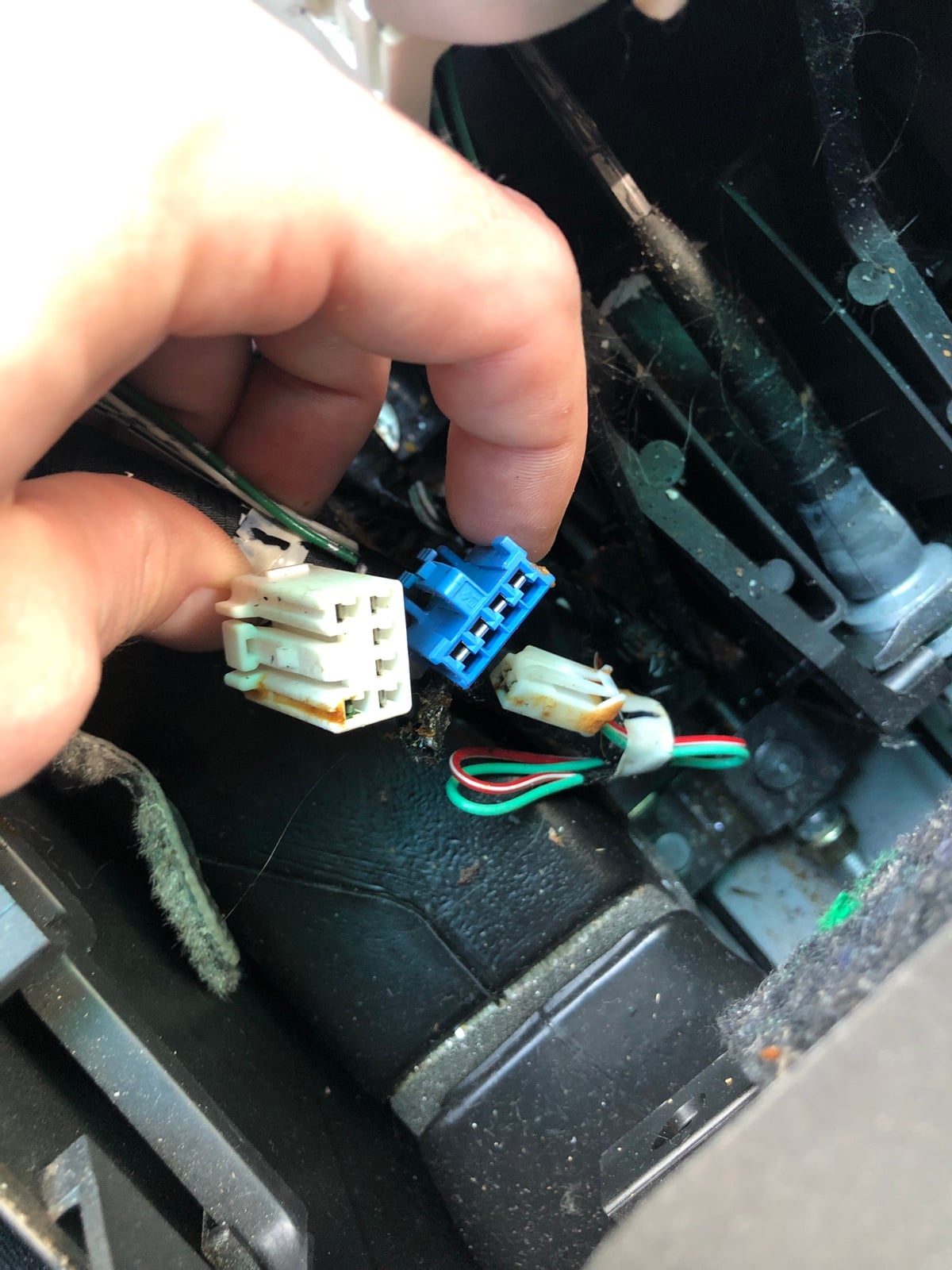

Removed the console today and I see that they probably unplugged and blanked out the dac. However, I see a 6 prong white and a two prong white plug, unsure what they go to. Any ideas?
I know the blue connection goes into the dac given the research I did. But unsure about other two.
pretty sure thats the cigarette lighter wiring for the smokers kit.
I just looked at mine 06 V6 Limited.
White 2 wire plug is my cig lighter.
Blue is DAC
2 (1)White and (1)Black 6 wire flat rectangle plugs are the seat heater controls.
White more squarish 6 wire plug (looks like the one you are holding with the blue) - unknown, mine is not connected.
Edit just looked in the manual. Page 2 shows there is a “Height select switch” there with them also. Most likely for the air bag equipped ones.
Oh, guess mine is an 05 from the manual and build date.
