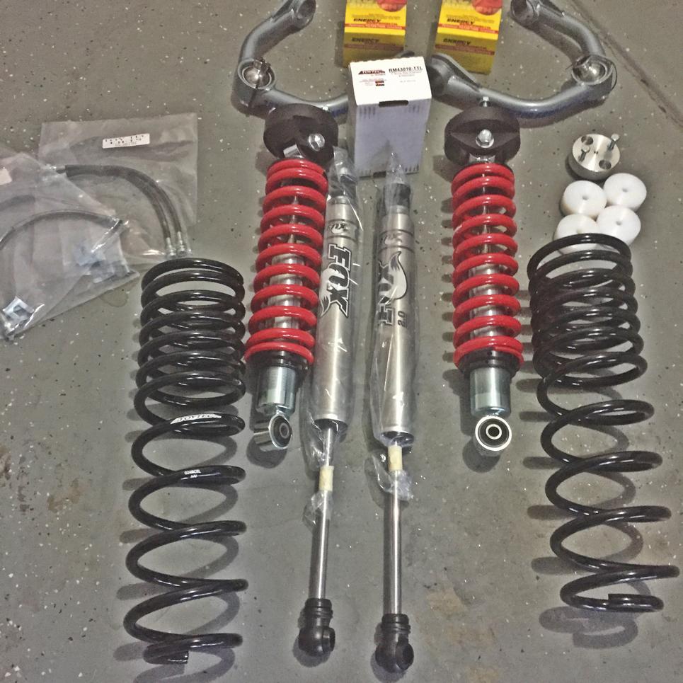

Just upgraded to ToyTec BOSS coilover system but yet to install it. Ive read nothing but great reviews for ALL types of driving/hauling except EXTREMELY harsh terrain at fast speeds.

What did you have to do to get those Fox Rears with the kit? they don't show them on their site. I need to get a heavier set of rear shocks bad.
Good eye.
I did have to pay a $50 upgrade, but the main reason was ToyTec was out of stock of BOSS and Billstein's the day I went in. I wanted to have all the parts ready for install.

Nice, I am having a hell of a time specing out shocks for my setup, any chance you could pull the part number off those for me? I am curious what the specs are on them. I am going to be running OME 861's in the rear for springs which should be about 5" over stock for the amount of weight I have in the back.
(2) 980-24-670-B

I have a 3rd gen also and I am also looking to get the Fox 2.0 rears to go with my 2-3" rear lift (OME 890s).
Did you ever figure out part number for the rears you have?
The shop I ordered from suggested these: Fox 980-24-679 (FJ rears), but as you mentioned ToyTec lists Fox 980-24-670-B (Tacoma rears) as being for 96-02 4Runners. I'm just worried the 679s will be too long.
