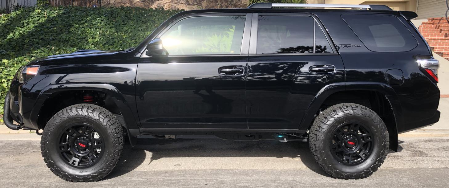

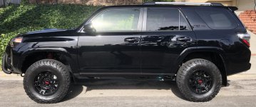

I added Cornfed 1.5”/1” spacers to my factory Pro suspension, which gives me 2.5” total lift up front with 1” rear. I’m running 275 KO2’s and I find it fairly easy to get in and out. I’m 6’3”. My wife who is 5’2” makes it in without too much problem and my 5 year old son climbs in the back car seat by himself just fine. I like the 275’s as I did not want to do a bmc, remove my mud flaps or modify my front fenders. My concern now is what JSparky mentioned about the sliders. I am installing my Shrockworks angled up, 3 tube, no tread sliders next week. They sit pretty close to the vehicle as compared to others and I don’t need them and don’t want them to be in the way for ingress/egress out of my 4Runner. They may be an advantage for my wife and son. We’ll see. Here is a pick of mine

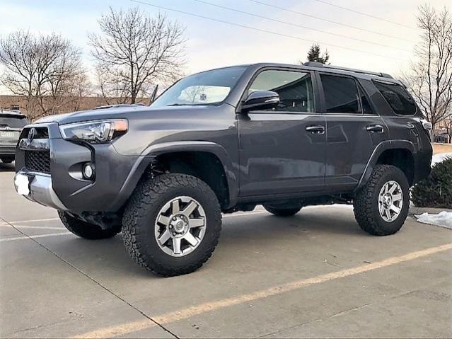

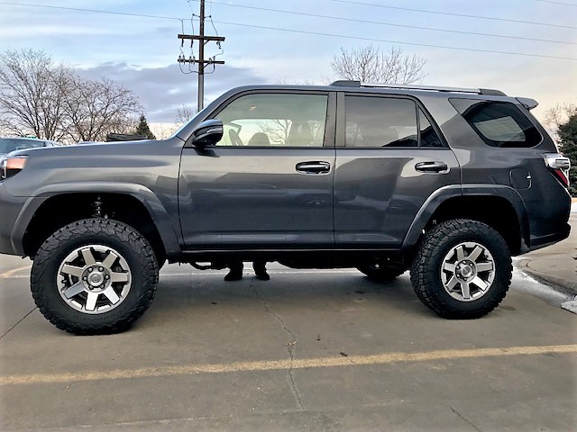

I have a ToyTec Ultimate that is set at about 2.5". It makes a difference getting in and out, but not enough to be a bother for me. I also load and unload photography gear constantly and have not found it to be an issue. For shorter people your mileage may vary. Putting small children in car seats might be a bit of an issue.
As far as a difference between 3" and 2.5, I doubt you will notice any real difference, but with the ToyTec Ultimate I think you have the option of more than 1 setting. I do have heavier springs in the front to accommodate the bumper and winch.
I have factory Trail running boards that I don't find real useful for egress and ingress. They stick out far enough that your shins will hit them on occasion. They do keep a lot of gravel and mud off of the rocker panels however.
I have not changed tire size and did not do the lift to get clearance to do so. I lifted to improve approach and departure angles of the front and rear bumpers. Tire size from 265 to 285 is only a lift of about 1/2" so it really doesn't account for much in the way of clearance.
You can argue that bigger tires look better, but I am more about function over form and don't need the aggravation of the speedometer being off and the loss of power when changing tires.

Hows the ride after putting on the spacers and tires? Seems like everyone has an opinion on adding spacers some say do it some say dont but all I want is to just add more lift while keeping my brand new pro fox suspension. Also how much mpg difference did you end up with? Looks good btw

The ride is decent. A little more responsive with the E rated tires and spacers as it preloads the springs slightly. A 'C' or 'P' rated tire would take some of the responsiveness out over bumps, etc. I'm not sure they have a spacer kit for the Fox setup yet. The tires, due to the weight made more of a difference on mpg than the small lift. I lost approximately 1-1/2mpg average with the tires and seems like another 1/2 mpg with the lift. I like that much of the nosedive is gone and it feels slightly better in turns. Everyone I have spoke with say the spacers, if not excessive, are just fine for normal off road use, which I plan on doing. I'm not going to be crawling over boulders like I use to in my previous 4Runner. I like the look and feel overall and would not go back to stock for a slightly cushier ride. Everyone as a different interpretation. Hope that helps.

Burtman Industries. Talk to Jason. He is on the forum.

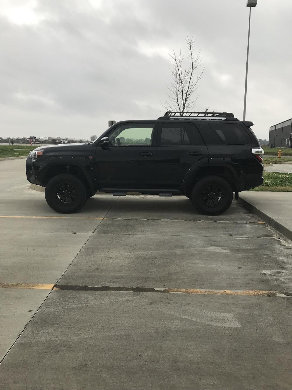

i have the Toytec 3" coilovers w/ billstein 5100's on front with 1.5 in spacers on back and bilstein 5100's there too. been on for 5 months and love the sportier handling when cornering or braking, much less body lean. i have the stock Terra Grappler tires on it that came with the package and have no problem getting in or out of the truck(i'm 5ft. 5in. tall).

Wow those tires look TINY. Makes me wonder if keeping the 265s and going 2.5/1.5" will look like this or if it's because of the flares.

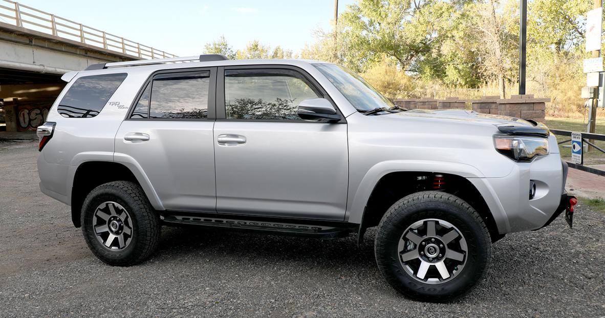

thanks so much for your help! reading on all the posts really helped me make the decision to go with with the 3" lift and I couldn't be happier.
I just got my 4runner back yesterday with a 3" Bilstein/Toyotec lift installed with SPC UCA's. The current tires are 275/70r17's and they dont look bad IRL. I will more than likely go one size bigger once these wear out.

Looks good. Will look great with 285’s. I like the trail wheels without the black accents like yours.
