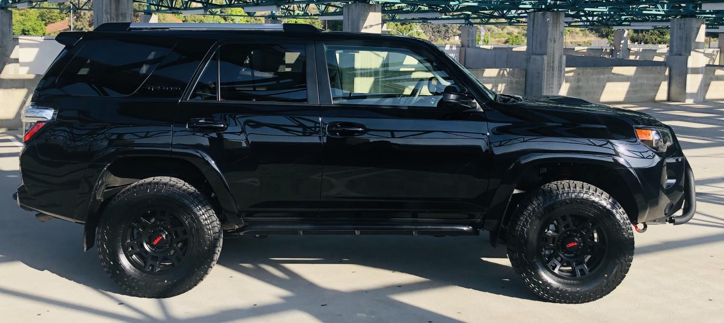

I did not need aftermarket UCA’s or a Panard Correction Kit (PCK) when I did a 1.5/1” spacer lift on my Pro. This equates to an overall lift height of 2.5” up front, Pros are already 1”
higher up front than other 4Runners. The rear was 1” higher. With the factory 7” wide Pro wheels with, as I recall have a +4 offset, I had no problems with fit and clearance issues. The Pros come with the fender liner mod and I did not have to cut or mod anything. There is a variance in all the 4Runners, so your result may vary. Pics when stock except spacer lift and 285’s.

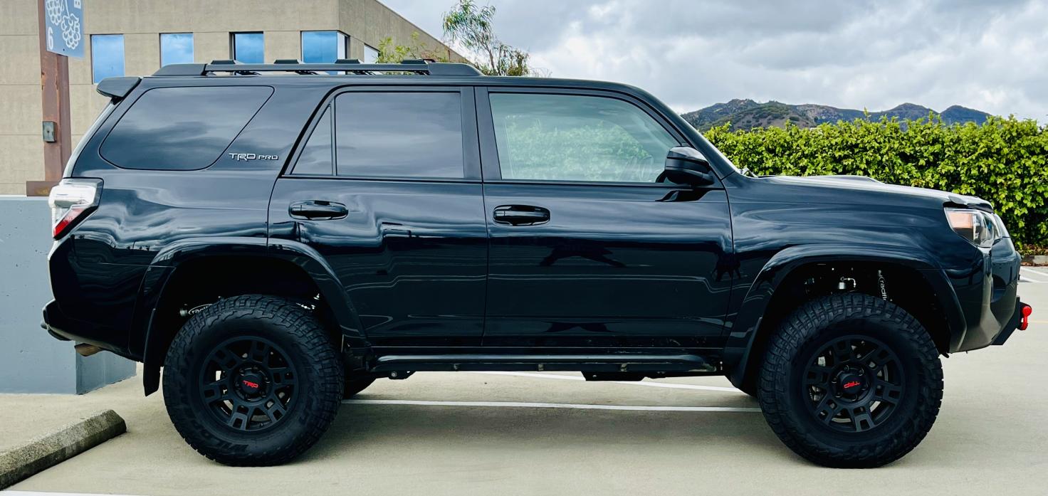

For reference. Some comparison pics. Stock with 1.5/1” spacer lift and 285/70-17’s versus 3” Radflo lift with reservoirs and adjusters. Center of hub to top of fender measurement. Top pic, 22 3/8” and 23 3/8” rear. Latest setup, 23 1/4” F and 24 1/2” R. I currently have full steel armor underneath with Warn Lo-pro bumper, which, the factory Pro suspension could not handle, hence the change. I may lower my current suspension down a 1/2”. Proper alignment is very important.
