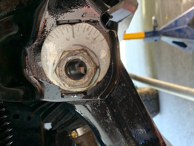

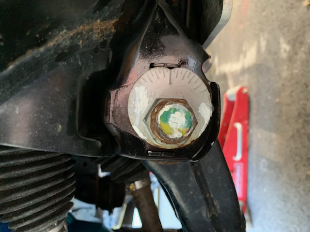

Took the vehicle in after I put the total chaos UCA on. Was told they could not do a proper alignment as the passenger front bushing was frozen. I thought possibly he may not have known how to loosen the nut first etc. Nice guy and said if I was able to loosen it he would redo the alignment for no charge. Ive got -1.6 camber with decent toe and castor 3.7 both sides.

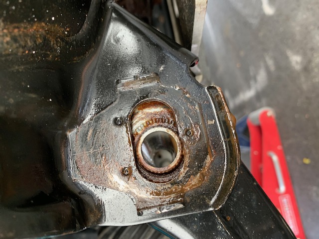

I've searched all around on techniques to get these off, though they were on other vehicles. I did all the suspension work, bumpers electronics etc on the truck myself but I am no expert mechanic. Gave it a shot with Liquid Wrench, hammer, torch this am...no luck. Even if I replace the lower control arm probably gotta cut these things out.
any other advice? I ordered up some SPC bolts, but also looks like OEM may be better. and while a set of TCA lowers would be nice, thats a steep budget for a part time off roader like myself. Its not my daily, but I also want this thing fixed asap. The whole bushing moves when I wrench in the big nut...

Yup. Just played with it again. After a few beers I ordered up the TC LCA. Soon as they arrive it’s time for the saw!! I am gonna F that metal up. Some major F bombs in the garage today. Only 2 years old and all seized up. The NE weather put a bearing on them.
Thanks for the links and advice. I ordered up some mouse milk to have around. The reviews I found on it were fantastic. The rears are no problem so I dont think I will even have to saw these out. There's enough play with the camber washer plate off and I can probably even bend the frame mount a little. The front of the sleeve is barely sticking out. If not, doesn't look like it will take long to saw through that sleeve. I tried to pound it out from behind. Perhaps I coulda been more patient and hit it with liquid wrench every 12 hours and work it out, but the system pissed me off and I dropped the hammer on the Total Chaos. I had just had the system aligned a year ago, and the truck is a 2017. I will lube the piss out of the new bolts.
I put it back together so I could still drive it till the new LCA come. I'll tackle that next weekend, and hopefully it doesn't take more than a few hours each side.

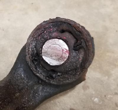

I spent three hours trying to get the first cam bolt off my son's 2003 former NY 4runner. Finally had to grab the sawzall for all 4 bolts.
The cross-section reveals why: the bolt, cam aligner, and bushing sleeve had completely fused together.
The sawzall with a Diablo carbide blade did make quick work of it.
