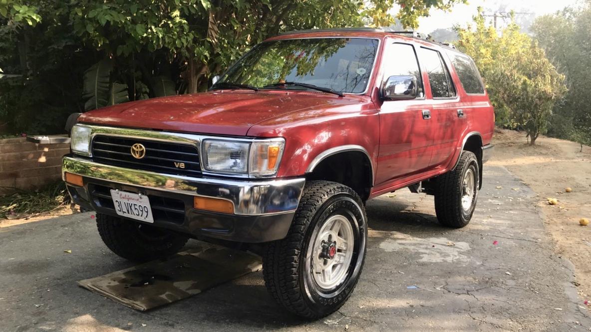

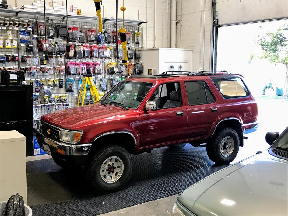

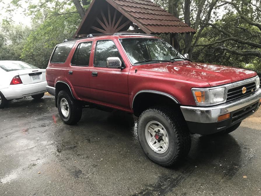

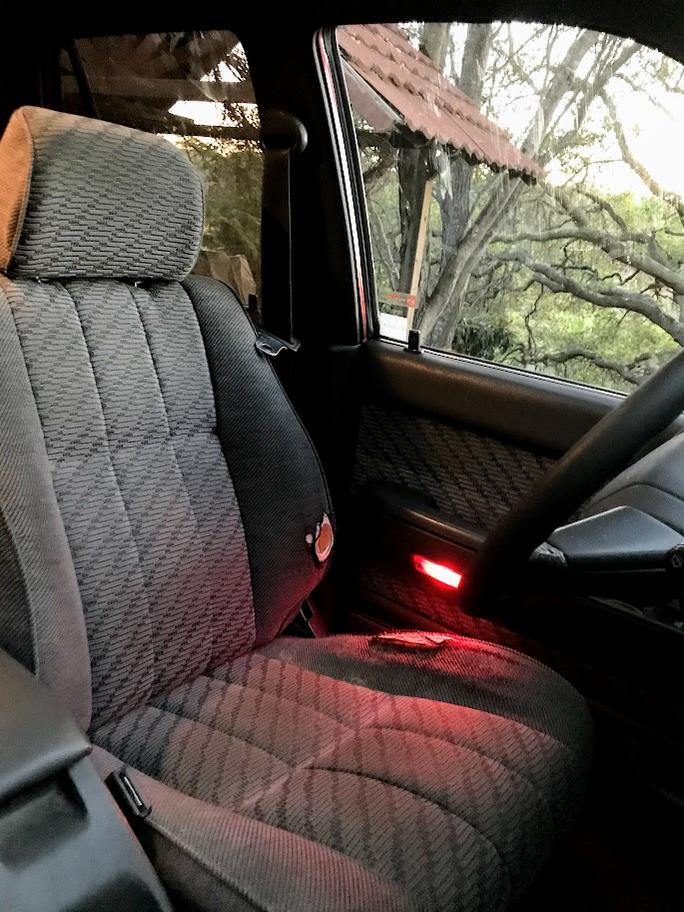

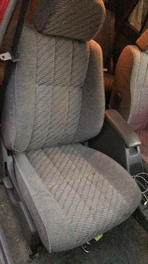

Lots of hopes and dreams here, but I'm excited about them. Once I get this thing SASd I can disarm the Tacoma's rock defenses a little and maybe build it into more of a go-fast truck/daily driver again. Until then, here are the few pictures I have of the 4Runner.
Wow! Your 95 is pretty clean!
Your list of plans sound like how mine started. Drove it for a year or so(sat in the driveway for 9 months when I noticed the tags were gonna expire so had to get it road worthy.)
They do drive pretty nice in stock form. SAS'ed they take on a new persona.
I wish I had gone 37's but didn't want to suck up the extra cost..its crazy to to from a 35 to a 37 you end up about another $125+ per tire on top of having to buy 17" rims.
Looking to see how your build progresses.
Also gonna have to check out your Tacoma. I bought an o5 when they 1st came out. Loved it but sold it back on 2009 when the missus bought a big travel trailer. Should have made her sell her Camry. .
