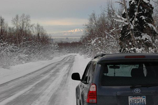

So like many others, I am not much of a manual or instruction guy. I tend to read it once to avoid major catastrophe, and then forget about it. Well, lo and behold the manual says don't use chains on the front . . . I didn't see this part. Instead, I took everybody's advice that having chains on all four corners is the best way to go.
It was the thwack/click sound over and over that got me to back up through the snow and return home (drove a mile maybe) . . . only to find after extensive search that the noise was caused by minimal tolerance between tire and body mount/wheel assembly.
Now I am praying that I haven't damaged anything major (the metal pieces can take the rubbing of steel loops for a mile - the bushings and grommets cannot). So, for those who come after me - DON'T PUT CHAINS ON THE FRONT WHEELS OF 4TH GEN 4RUNNERS.
Feel free to pelt me with criticisms and snickering . . . I deserve it : )
It takes a special man to be able to admit errors both in judgment and in application. I thought that I would join you this year for crossing the Yukon in winter without a Sat Phone. Luckily nothing happened which was by sheer luck of clear weather. for yet another year, however there is always hope for me.

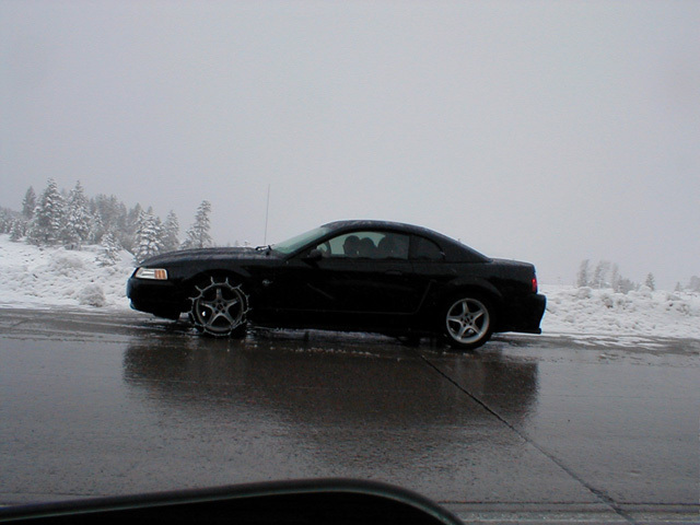

Don't feel too bad. At least you didn't do what this guy did...

haha i've seen guys put them on the wrong tires before. i almost did that once when i wasn't thinking straight in 10 degree weather and in a bit of a hurry.
