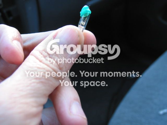

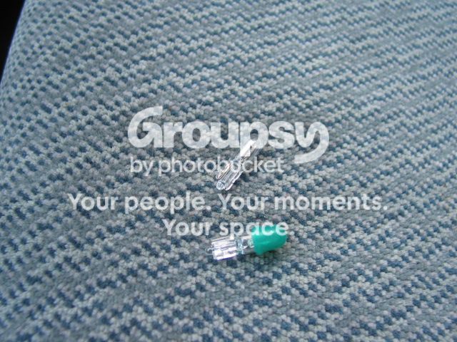

For people that want to keep the green:
Here is the old bulb (green) next to the new bulb (clear)
IMG_0146.jpg~original
Carefully roll the little green bulb condom off the old bulb. Roll onto new bulb.
IMG_0149-1.jpg~original
