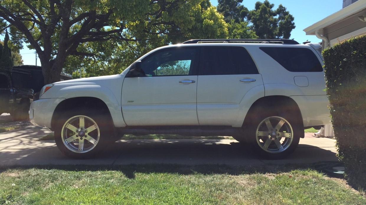

Update:
Thank you all again for the help.
I managed to get the 2.5/1.5 Daystar kit installed on Saturday and here are some impressions:
First, the install took longer than I expected because it was my first time doing this job and it was also my first time working on the suspension of this 2006 4Runner as we've only owned it for about a year. It took me about 8hrs working with jackstands + hand tools with a couple breaks taken in between along with an oil change in the middle too. However, if I were doing it again I'm confidence that I can get the kit installed in 4hrs or less now that I'm familiar with everything. It is more or less a 4hr job...
Rear: I have heard some guys say that they got the rear kit in by just disconnecting the lower shock mounts, lowering the rear, and prying the spring in and out. I was able to get the springs out in that way but no way I could get them back in with the 1.5 spacer in there. I finally had to disconnect the driver's side panhard mount and the driver side sway bar link. Once I had those disconnected, I could lower the rear enough to allow the springs to slide back in without too much fuss.
Front: I ended up using the advice on this forum and rather than disconnecting the upper balljoint from the spindle (like the Daystar directions say), I just unbolted the lower balljoint from the spindle (2 bolts). I found that easier than fussing around with trying to break the upper ball joint free from the spindle.
Removing the strut/spring combo was fairly easy except for that back upper nut. Because of limited room, I had to use a box wrench turning small increments until I got it out.
For reinstall with the spacer bolted to the top of the strut assembly, there was absolutely no way I could push the lower control arm down enough to get the lower strut mount to line up with the mounting hole, I wasn't even close (even when I put all my weight on the lower control arm it hardly moved - I weigh 215lbs).
So I had to loosen the two big lower control arm bolts making sure not to move the position of the camber bolts. I marked them, but luckily the camber bolts never moved at all. Once those lower control arm bolts were loosened a few turns, the lower control arm could be pushed far enough downward to get the strut assembly bolted back with the spacer in place. Once I bolted the strut assembly back in, I made sure to jack up the lower control arm before I torqued the lower control arm bolts.
Oh, and I did remove the front lower engine plate and sway bar to gain more room.
Once I dropped the car and backed it out of the driveway, here are the numbers I recorded measuring from the ground to the center of the wheel arch (I expect the fronts to settle a little more after some miles):
Front Driver Before (After): 32 7/8 (35 15/16)
Front Passenger Before (After): 33 3/16 (36 1/4)
Rear Driver Before/ (After): 35 5/8 (37 1/8)
Rear Passenger Before (After): 35 3/4 (37 1/4)
You can see that the rear raised exactly 1.5" as I expected. The fronts raised a little more than I expected at 3 1/16", but again I expect that to settle down to 3" or so.
Lastly, you can visually see that the wheels have more positive camber and toe in, as expected. An alignment is in order...
Overall I'm happy with the results as the kit did what I expected and it was relatively cheap at only $125 or so. Hopefully this thread helps some of you guys who plan to tackle the job.
Next I'll work on getting a nice set of all-terrain wheels & tires!
Here is a pic attached
