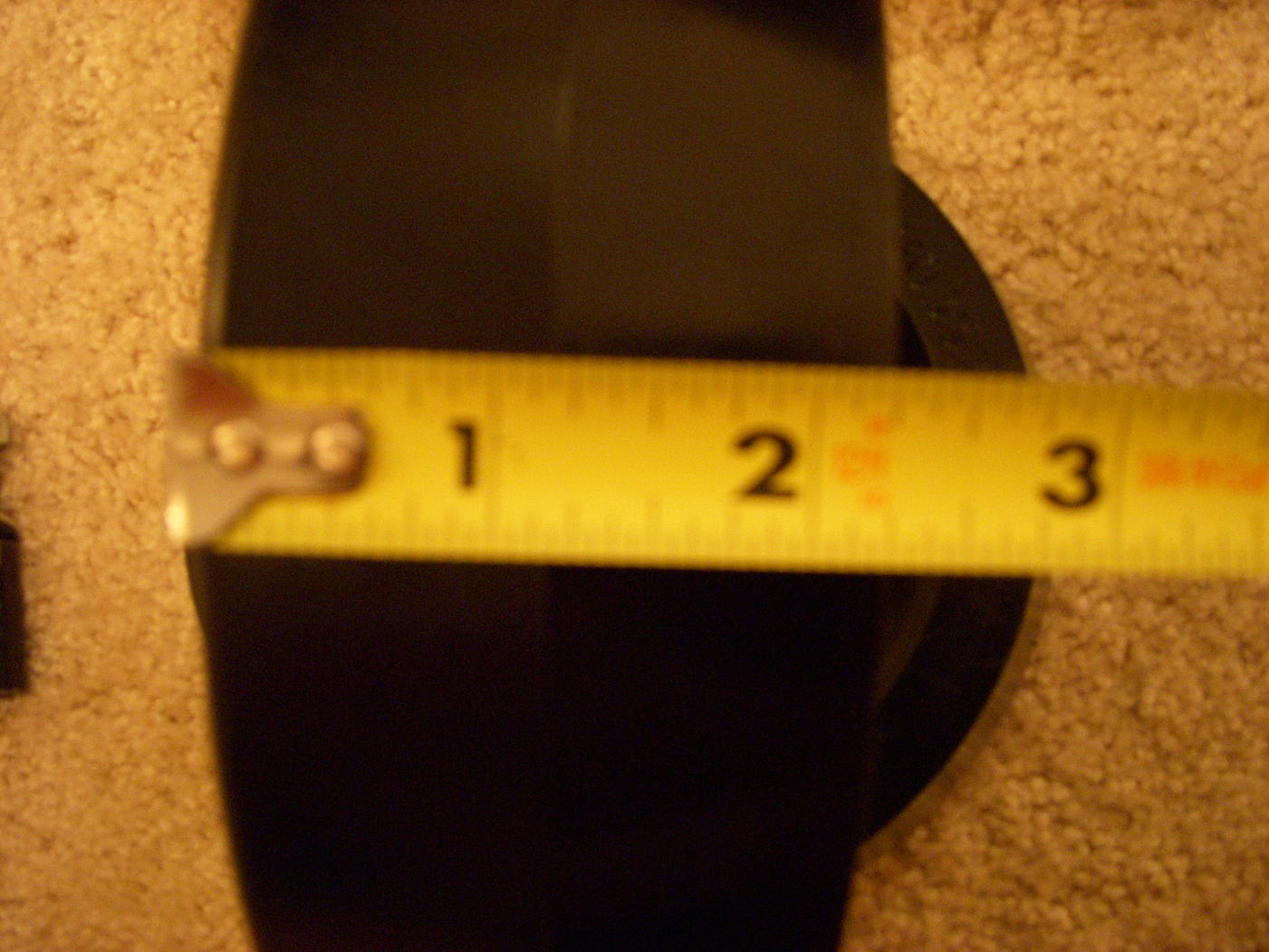

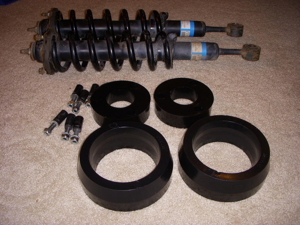

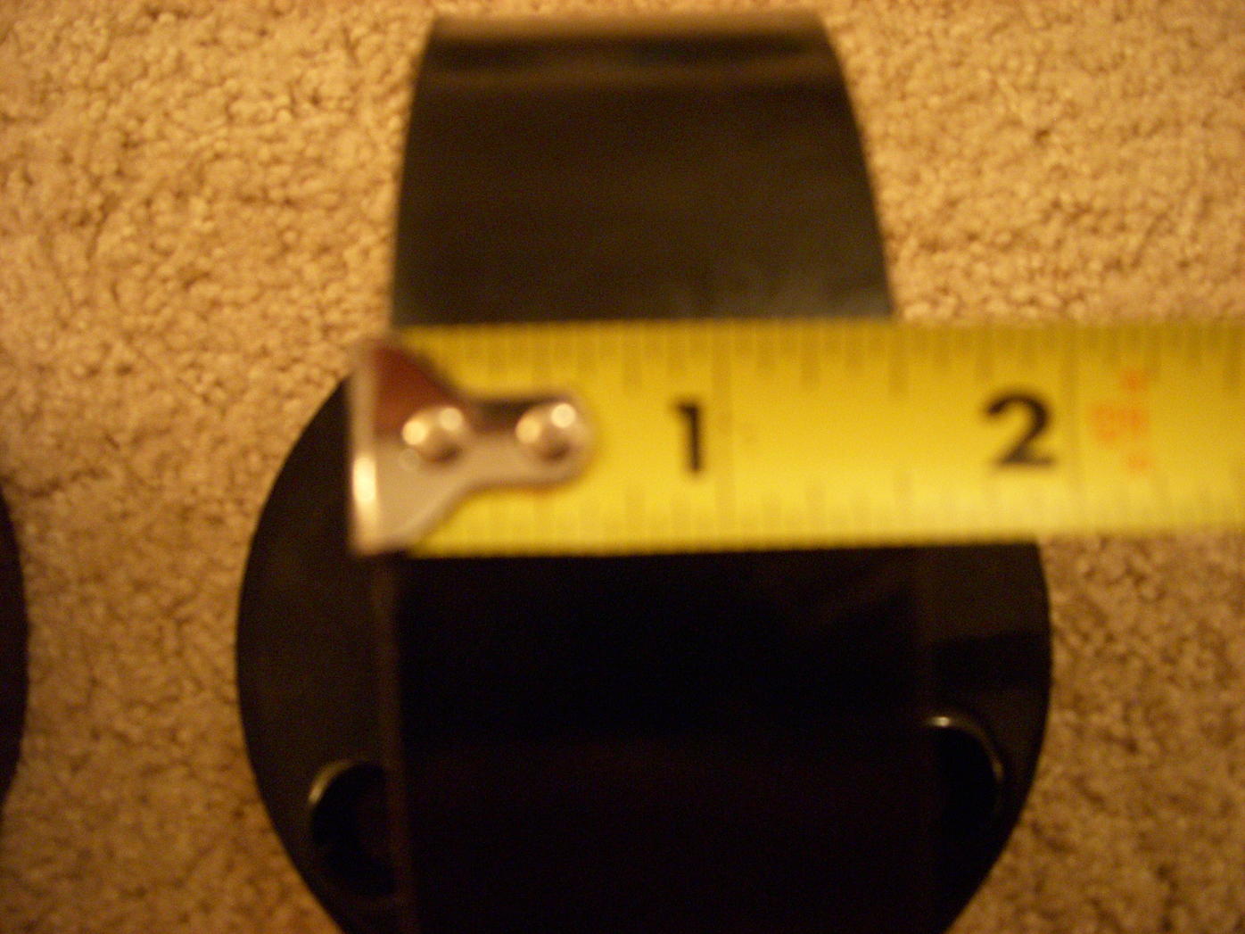

For clarification on my setup i took some pictures.
Sorry about the quality, my camera's not that great.

Im just measuring the height of the actual spacer
Hopefully this clears up your confusion a little bit...
Due to the geometry of the front suspension, a lift will yield a rough 2:1 ratio. A 1" spacer will net 2" of lift. a 1.5" spacer will yield about 3" of lift. The rear spacers will lift at a 1:1 ratio because of the live axle. If you had an actual 3" puck to on top of the strut, you'd never get it in place!
Also expect your spacers to settle a bit. When I did mine, it settled about a 1/4-1/2" up front and about 1/4" in the rear. This seems to be the case will the all top out spacers vs. the old preload/top out setup.
