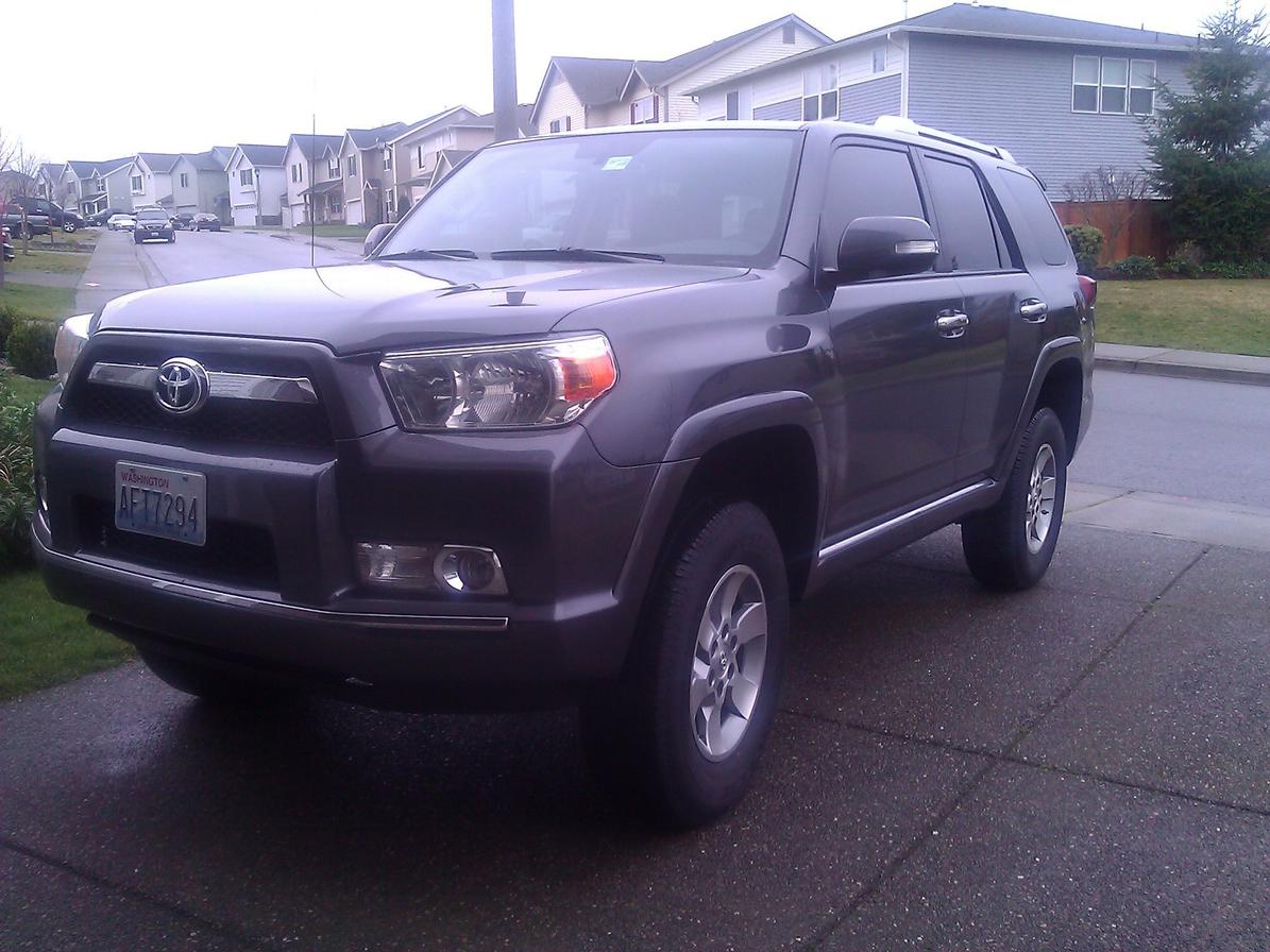

Here's my measurements from the Center of the Wheel Wells to the ground before and after the Daystar lift was.
Before: 34.5" Front; 37" Rear +/- .25
After: 37" Front; 38.5 Rear +/- .25
I installed the front 2.5 spacers and every thing sat level. Then I had my old man (250 lbs) jump into the back of the 4runner. The back of the 4runner sagged about a 1". So I tossed in the rear 1.5 Spacer.
With stock 265 tires I clear the standard garage door with plenty of room.... except for the stock FM antenna. Which I have about 1/8" Clearance.
I am buying new tires Thursday...

It rides and handles just like stock. I and the rest of the family can diffanilty notice the difference in climbing in and jumping out, Specially with my 5 year old. I have to lift her in all the time. Its not bad at all but steps are in order.
As for the stance with the stock 265's, this is the way it should of came from the factory. The only reason I am swapping my tires out is because I want more of an aggressive tire for a 4 wheel drive.
Today I stopped by discount to see what they had in stock. They had both the 265's and the 285's. I had them try on the 285's on the stock rim and they fit fine with just Slightly rubbing on the bump on the front of the fender liner. It looked really good. I am just having a hard time with the mpg. I keep leaning toward the 265's. Hope someone will sway me one way or another. Cant see how it can change that much with only being .5 dia. Difference in size.

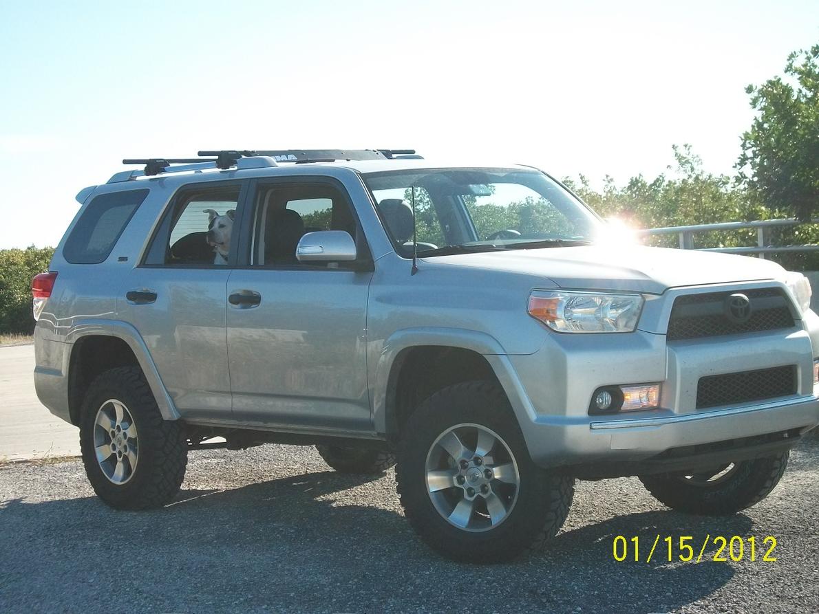

Here is a picture of my ride after the Daystar lift.
I am very pleased with the way it turned out and my truck sits completely level. My measurements (from the center of the hub to the bottom of the fender) are:
Before: (Front=20.5 in and Rear=22 in)
After: (Front=23.0 in and Rear=23.0 in)
For tires, it came down to a more aggressive tread and trying to minimize the impact to my fuel economy. I knew I was going to do the Daystar lift and through this forum got turned on to the Duratracs. I chose the load range C size 265 because they are 6 pounds lighter per tire than the load range E. Keep in mind, they are still heavier than the stock Bridgestones so they will effect mpg’s. I was a little concerned that the 265’s might look too small with the lift but I think they look great and hopefully saved some mpg’s.
So far, I love the lift and tires. It’s a huge improvement over the stock Bridgestones and I am very pleased with the ride and handling. My gas mileage has decreased by about 3 mpg from a combination of the Duratracs and the Daystar 2.5 inch lift.
I plan to go with OW 2.5 inch lift after my warranty runs out and the Daystar is the perfect subtle starter lift.
Stu

Looks great Stu. I was wondering why you had more wheel gap than me, then realized you are on 265s. I think I will be taking my skirts off today to see how I like the look on my truck. They will be coming off for some NFAB or sliders soon anyway.
Brock,
Thanks man! Your thread was the motivation for me to get the lift. I am very pleased with the lift and get a lot of compliments.
Stu
