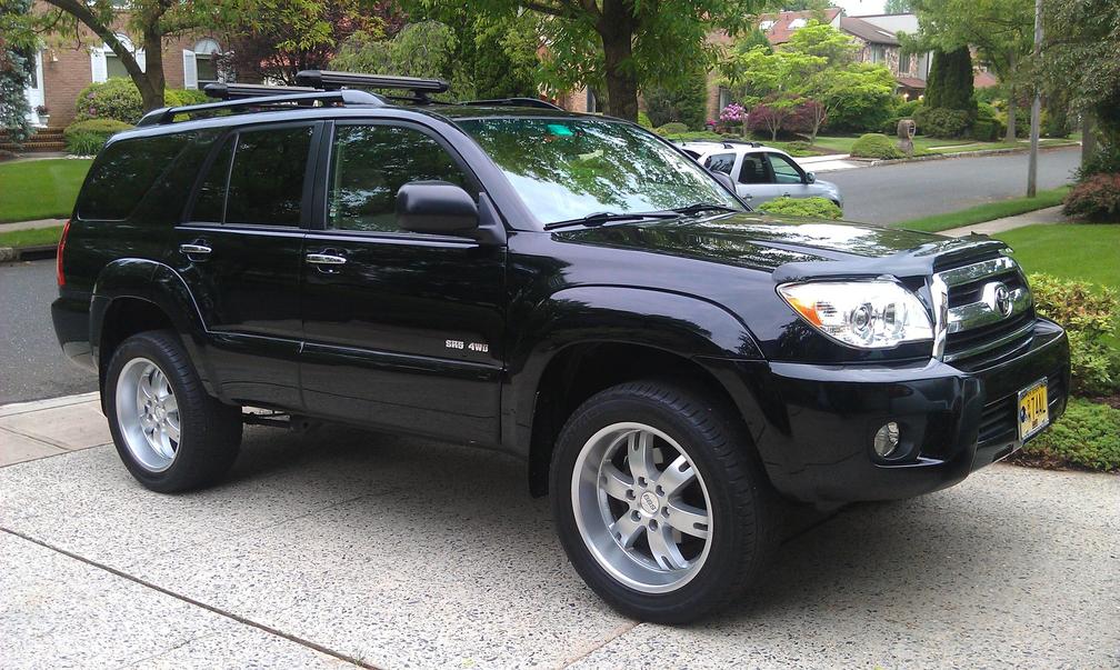

SO I come back to you guys for some more advice on how big I can go on tires with my stock 17 in rims. Im not the most car savy person but have learned a lot of from my fellow t4r'ers. I currently have a 2006 sr5, with a daystar leveling kit, i have 285/50/20 tires on(3-4 inch lip), I did do some bumper trimming and moved my wheel well liner forward apprx 1.5 inches. Im looking to buy a set of more aggressive tires for winter use (snow and ice) and wheeling. Ive been using a tire calculator to try to help determine what size I can fit with out have to do any drastic trimming.

those are old tires(295/45?/20) . my current ones are nitto 420s 285/50/20, from reviews Ive read they arent ideal in snow. and Id like something that I know will get me where I want in over a foot of fresh snow. Recommendations on tires would be appreciated too, I was thinking BFG A/T or General Grabber AT2 ??
