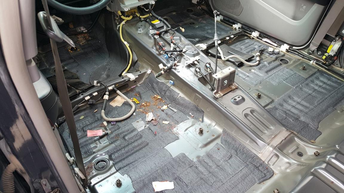

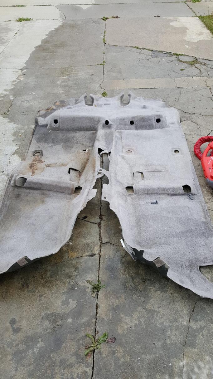

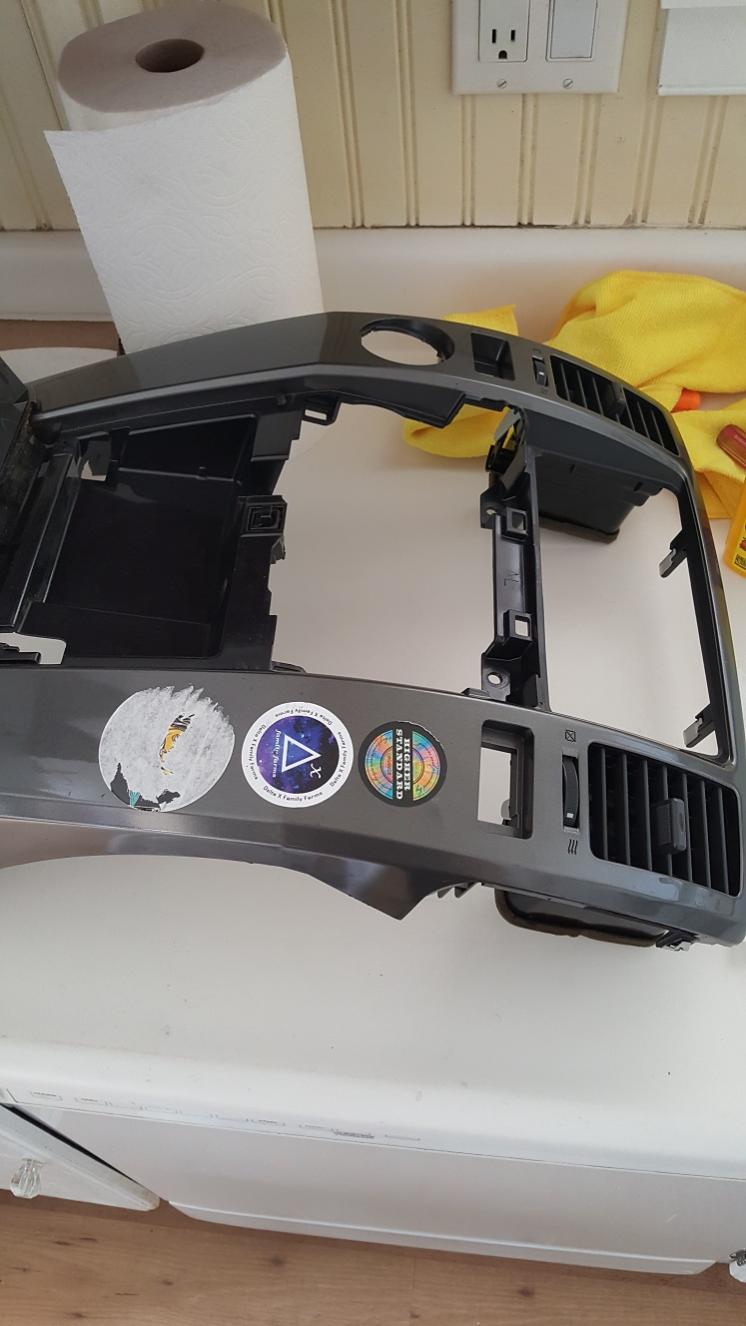

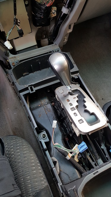

In the state of California the DMV gives you ten days to transfer title of vehicle you bought. Do to the COVID-19 pandemic my local DMV was closed and the next closest one was only taking appointments. I got an appointment nine days from when I bought it. So while I waited I thought I would super clean the interior. I rented a Rug-Doctor upholstery cleaner and started cleaning. The more I cleaned the more I was taking the car apart. Out came the seats. I took the dash a part. The center console had to come out. There was so much marijuana I could have rolled three big fat joints from it. I determined that at least three Starbucks Mega Latte coffees were spilt. Two in the back seat one in the passenger seat. The grossest thing was some kind of purple juice under the rear seats with these dried up prune things that looked like turds. Ugh! On a positive note I got about $2.50 in change out of it.

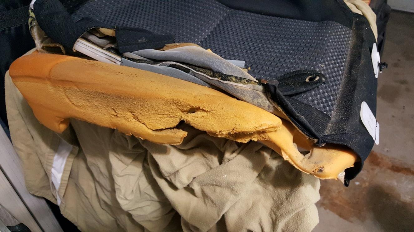

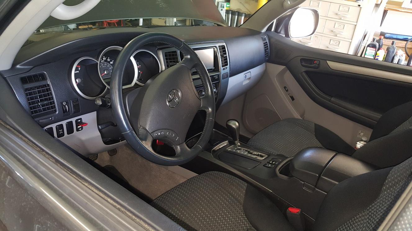

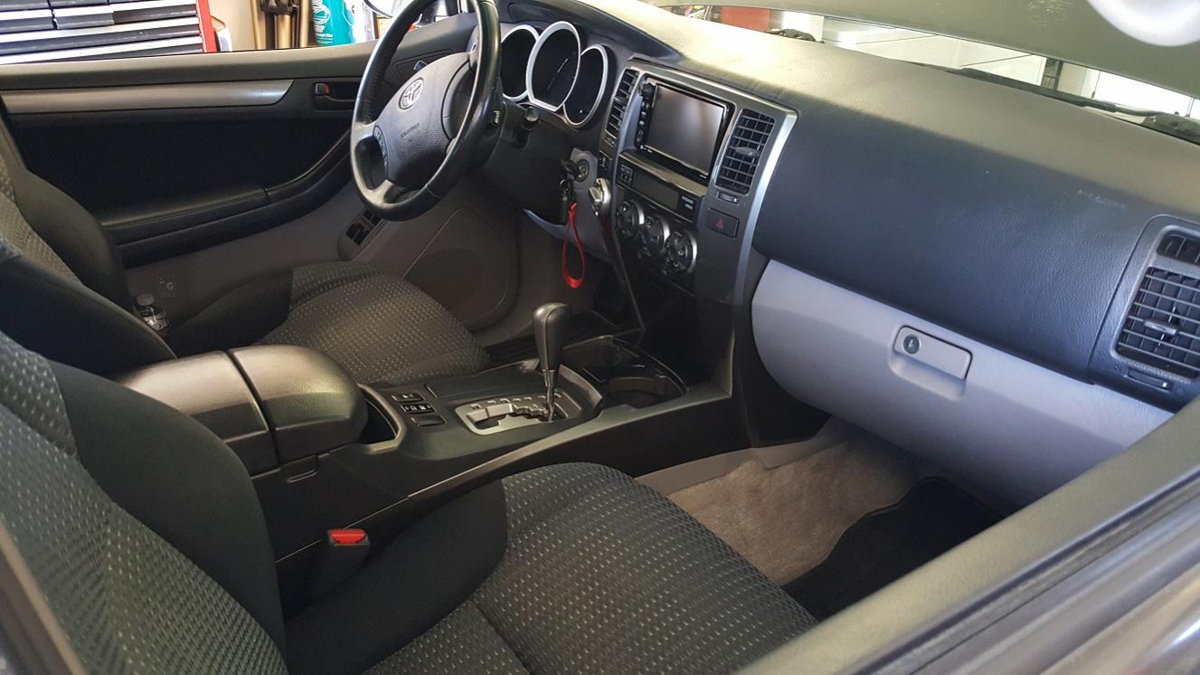

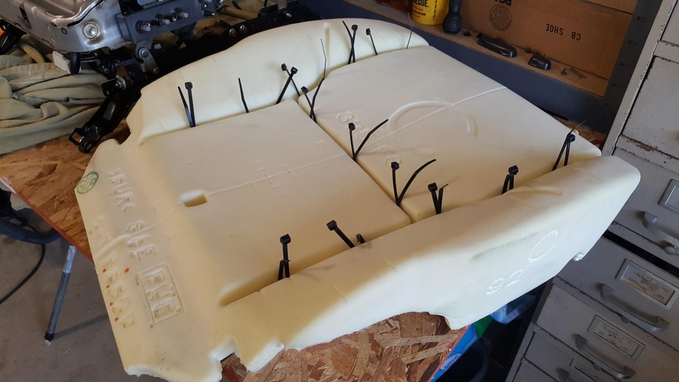

The first week I owned my 4Runner I bought PT546 1C182 radio off of Ebay for $70. The original radio was still in the car, but I know that they had installed some kind of aftermarket stereo because I found extra cables and speaker wires under the seats. I put the PT546 in the dash after I finished cleaning everything and it worked and looked great. The whole interior cleaned up nice. I bought some floor mats and the rear cargo carpet from Olathe Toyota. I found all the cargo nets stuffed in the side cubby by the spare tire tools. They looked brand new. I even found the first aid kit in one of the cubbies! The best thing I did was change the drivers side seat cushion.All in all I think the interior went from a 5 to a 8.5 with just some time and elbow grease. Oh and $350, not counting the stereo.
