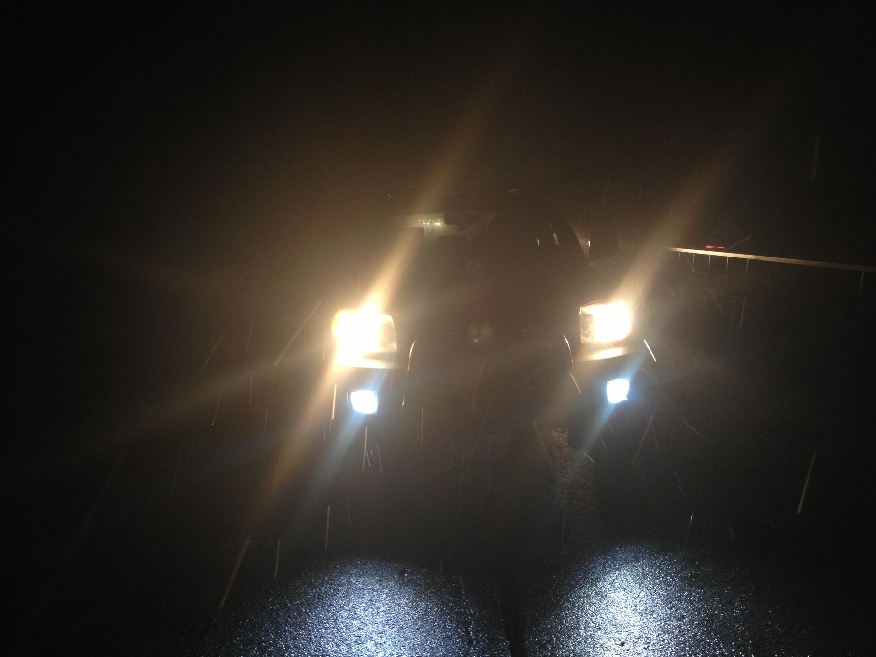

Anyone else have trouble getting the 9006 bulbs into the fog light housing? It feels like it is JUST too big to the projector... any ideas?I tried forcing them, but I could only get 2 of the 3 plastic tabs to twist in and its kind of cock-eyed, but looks fine from the front. I'm worried about water getting in there.

Yes, it's a pain in the ass getting it in. What I did was push the bigger tab in first and wiggle it till the others go in. Take out the stock bulb and and look at exactly how it's in, then put the HID bulb in the same way. I thought I was going in the right way but until I held the bulbs side by side, I was a little off.

Save your money and buy a better kit, the retrofitsource is 100x better than the ddm, theres never any issues on my end with theretrofitsource, ddm has provided me with wrong color on the bulbs many times. Those look like some 8000k , 6000k is a white with little blue.
I'm actually pretty happy with the kit itself. Mine are all 5000k and look very white. The fitment is the only issue.

installing mine now and swapping the oring out from the stock bulb was the ticket. The DDM 9006 bulbs have an oring twice the size of the stock bulb and it wont fit out of the box.
it also fits in fine with no oring but i decided to dig out the old bulbs and put the thin ring in for peace of mind
