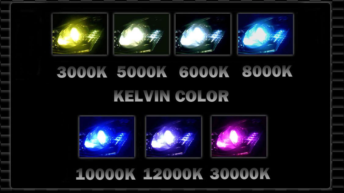

How do you pick what color you want?
See the picture with the kelvin colors/range:
Yellow= 3k all the way up to 30k which is a purple and very dangerous for night time driving, cause you cant see diddly squat.
my favorite as I am sure a lot of us agree, is 3000k/3500k (Yellow) for fogs, and for headlights/driving, the best is 4300 or up to 5k no more than that...
ALSO to answer your question, you email them your specific color/kelvin and let them know you want 9006 specific, as soon as you win the auction, that way its a plug and play for your 4runner.

i have ddm tuning hids....lows and fogs....i got 35w 5000k bulbs for all mine but according to these charts i would rate my color temperature at more like 8k....not at all what i was looking for and not really impressed with how different they are compared to how they are advertised....fyi ddm is probably one of the top 3 worst companies i have EVER dealt with lol....the only reason they are worth dealing with is because their products are so cheap. But they are also very cheaply made....all my wiring connectors were installed backwards...and 2 of my 4 lights fail to ignite 1:10 times....but good luck lol
