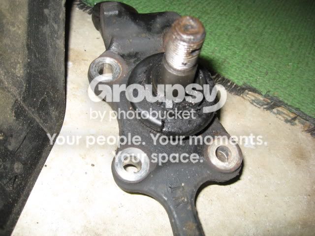

I am reviving the thread since I just replaced a friend's girlfriend's LBJs this evening. The procedure is fresh in my mind. Fifth pair I have done. Once you do one, the rest are easy. All new LBJs have been Toyota.
The culprit today:

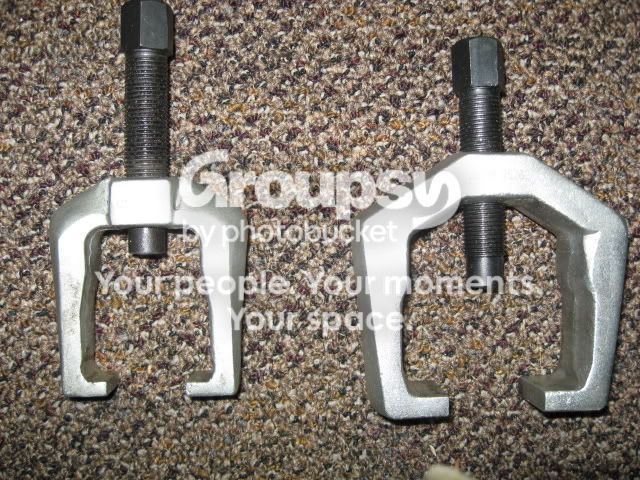

I always use these OEM parts pitman arm pullers. Other tools are a torque wrench that goes up to 150ft/lbs; sockets: a 14mm (4 bolts), 19mm (tie rod castle nut), 21mm (lug nuts), and 24mm (castle nut for LBJ). A long 3/8" ratchet, the blue loctite for the 4 bolts, a BFH and some penetrating lube make it an easy install.

Just a couple of possible helpful aids:
1. The little arm puller I have to wrestle in there in the beginning from the top to pop out the tie rod end. It is not as easy as using the bigger puller to pop out the old LBJ. Make sure the 4 bolts are loosend first as per the FSM.
