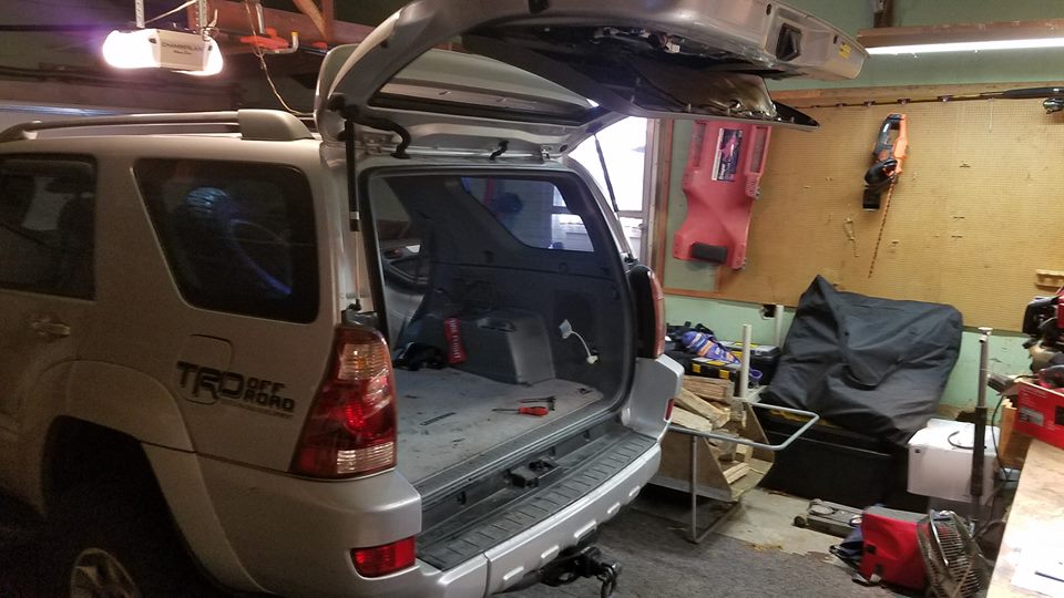

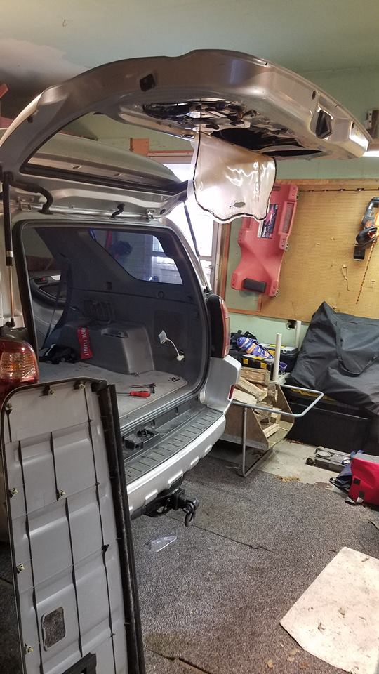

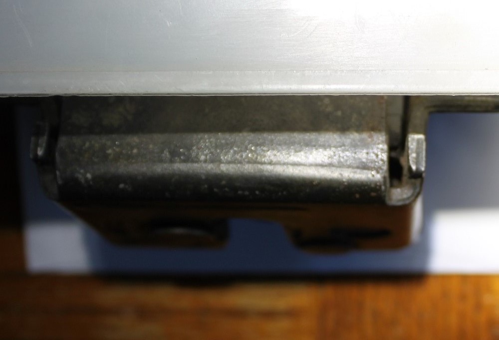

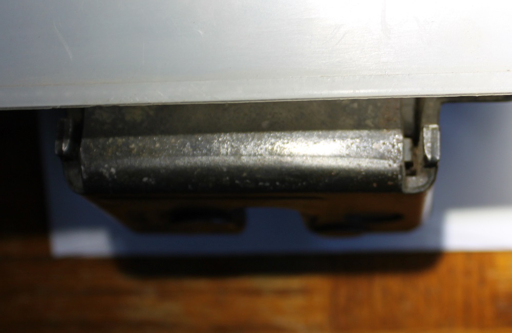

Who else has run into a case of dead tailgate?
Was it the soft close actuator latch or the button ?
Tips, Tricks and explanations appreciated.
worked fine one day, stopped working the next.. Window and wiper work normally. Very little if any corrosion visible inside door and inside lock. Ive tried resetting battery, locks, key lock on door. Unplugging harness and re plugging it back in. It doesnt make noise or anything.

Usually if the latch assembly is failing it struggles and still makes noise.
I'd be checking for power at the ECU-B fuse under the hood. Pull out and do a visual inspection of the legs, this action should also do a hard reset of the tailgate ecu after 30 seconds of being out. Maybe check the wire loom at the tailgate hinge as well for any signs of damage.
I have replaced 2, one on mine and one on a relatives. Mine just completely quit working one day and the other was intermittent. Replacement fixed both. I purchased the most recent one off EBay about a month ago for $176 and it was genuine Toyota.
i just did this last weekend.
ordered the motor off amazon and installed it within an hour.
had similar symptoms to you and it works like a champ with the replacement part. you confirmed your tailgate computer works since the glass rolls down, etc. so its just the latch motor, first link you posted.
mine was latching and then unlatching immediately for me to realise it was faulty.
Thank you! appreciate the feed back. Im going to try the fuse first.. but id say most likely ill be ordering the latch assembly.
it always worked fine, never had an issue.. didnt open it for about a month or so then one day I tried and it just decided to die.

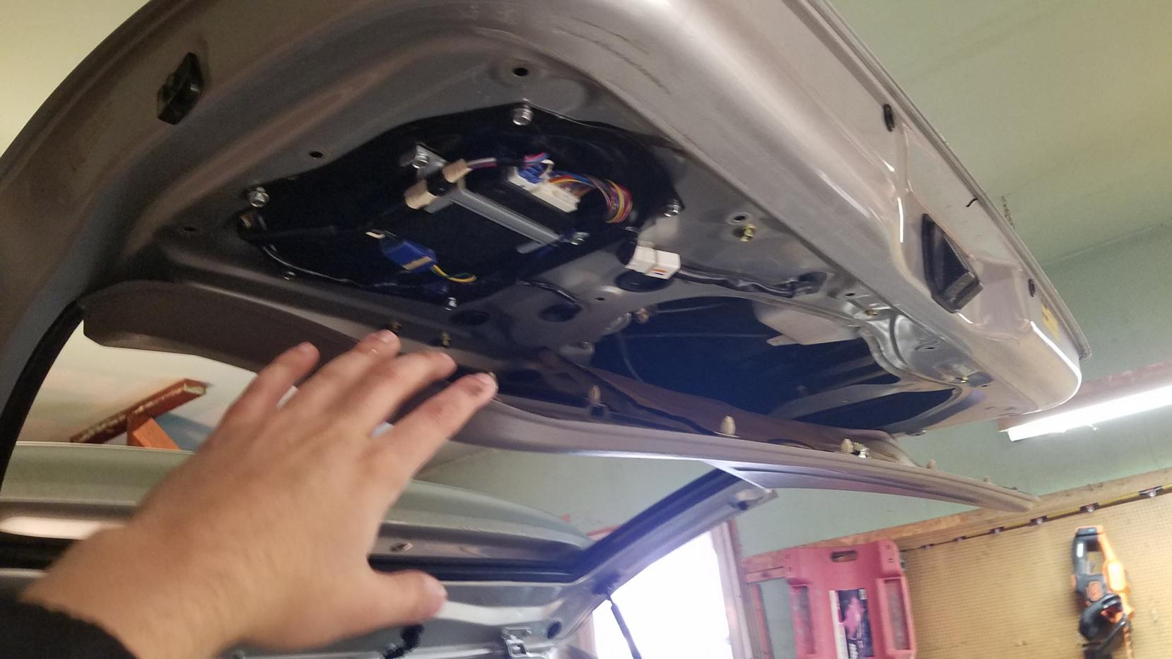

manually unlock the door from the inside using the little levers through the service door.. take the panel off, remove the few 10 mil bolts and carefully disconnect the lock mechanism. remove it, clean it out real good and then lube it up with generous amounts of wd14 or the like..
Reconnect everything
pull the rear door fuse I believe its ECUB 10amp for 20 minutes or so..
Put it back in, and immediately lock and unlock 5 times, roll up and down drivers window 3 times and roll up and down rear window 3 times..
Not sure if thats exactly the correct calibrate sequence but this should re calibrate the lock ecu and it seems to work normally again.. this is the second time ive been through this.

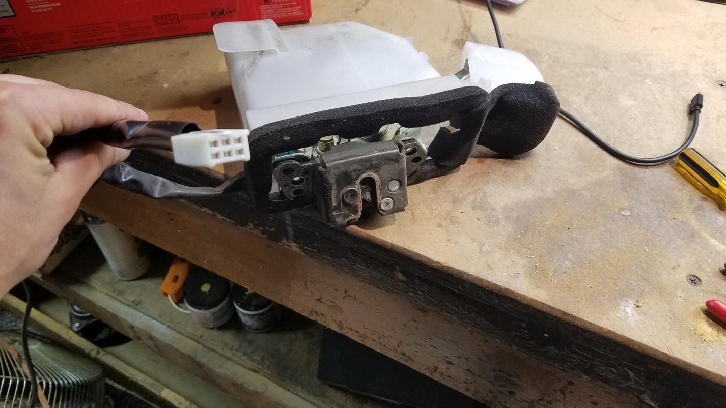

[MENTION=261255]Cloud9[/MENTION] I did that with just the first amazon part you linked... The job wasnt too bad if I remember right and it works perfect now. Mine was grabbing then releasing, wouldbt latch before I replaced it.
My actuator just died instantly. No struggling or intermittently working beforehand. Went to the grocery store, opened the liftgate to load up, got home liftgate wouldn’t release.
Somewhere on this site I found a process to test the switch (basically test resistance). Switch was ok. Replaced actuator and all was good. Easy job replacing the actuator, it was much more work pulling the switch out to test.
