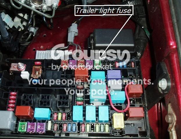

This 40 amp fuse is for the trailer lights. To answer your original question: The relay is behind the plastic that covers the rear wheel fender (inside the car) on the drivers' side.

Thanks Chris! Pictures are good for the impaired like me - I'm going to replace the fuse just fork S&G (defecations and hilarity) and see is that fixes it; I'm not real enthused about removing all the plastic - are the screws under the carpet d'you think?
How involved is it getting to the relay...?
Thanks again for the PHOTO!

This shows how to remove the plastic. Although it's for the passenger side, it's the same thing.http://www.castulucci.com/projects/carpc/oemnaviecuaccess/index.html
