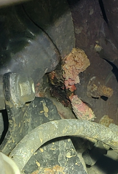

Dealer that sold me a 2006 4runner w/ 140k is trying to tell me this isn't a head gasket leak.
Can "stop leak" hide a leak well enough that if the system is pressure tested it, it won't show up?
I'm extremely suspicious of them claiming their isn't a problem.

Where is that leaking from? You cant really see a leaking HG unless you open up the heads. Are you getting symptoms for a HG leak, like rough cold start, smoke in exhaust, waterfall sound behind dash, cylinder 6 misfire?
What is your CEL code.
Need more info
Take it back to the dealer, when did you buy it? Thats been like that awhile.
Seems like 2006 should be past the dreaded hg issue.

I am with phatcheeks...
Looks like water pump or radiator or hoses or thermostat housing... some kind of front end cooling system deal.
If your diy, wash it all off then pay attention to were it leaking from.
