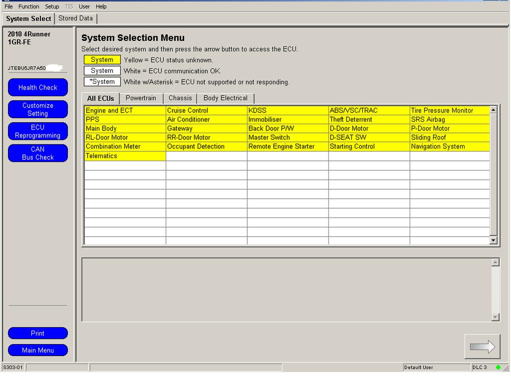

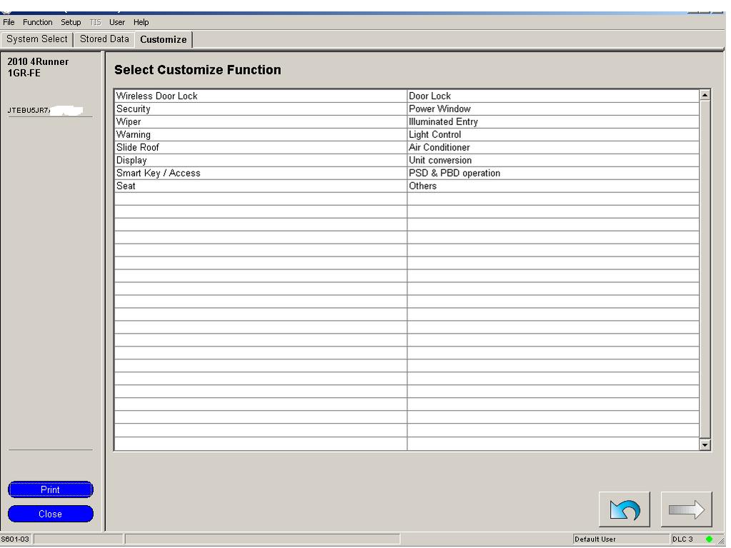

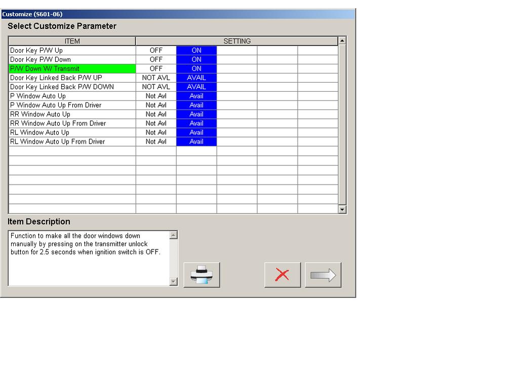

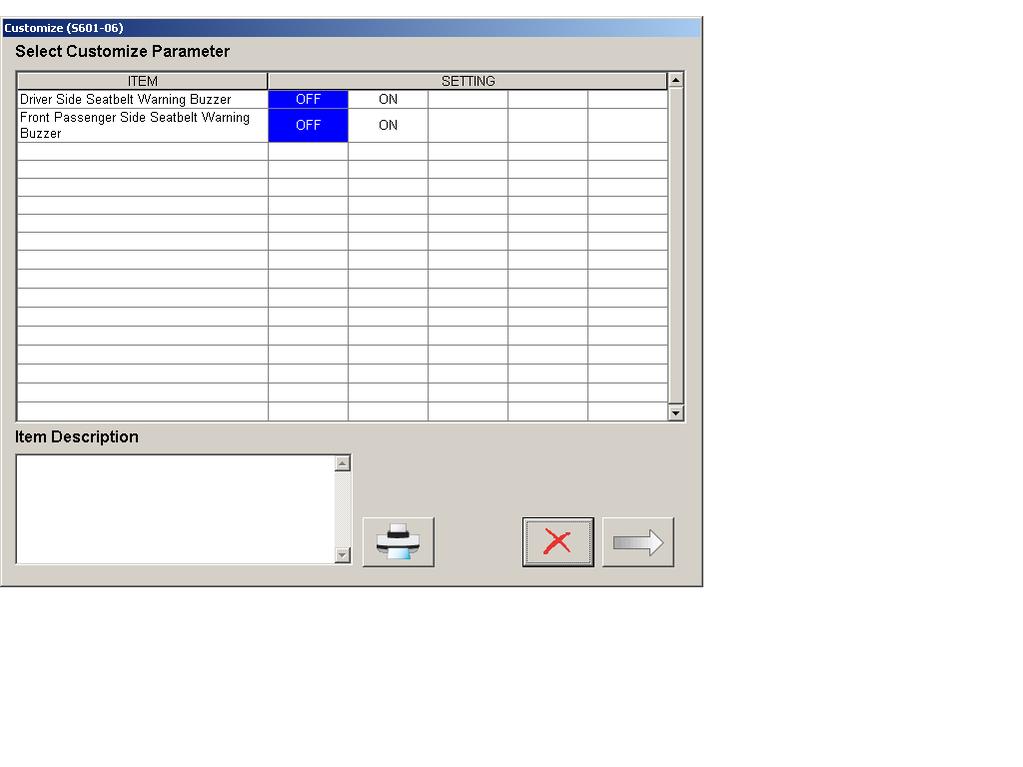

Here ya go...
Main Systems Select screen
Customize screen
Customize Seat screen
Customize Power Windows Screen
