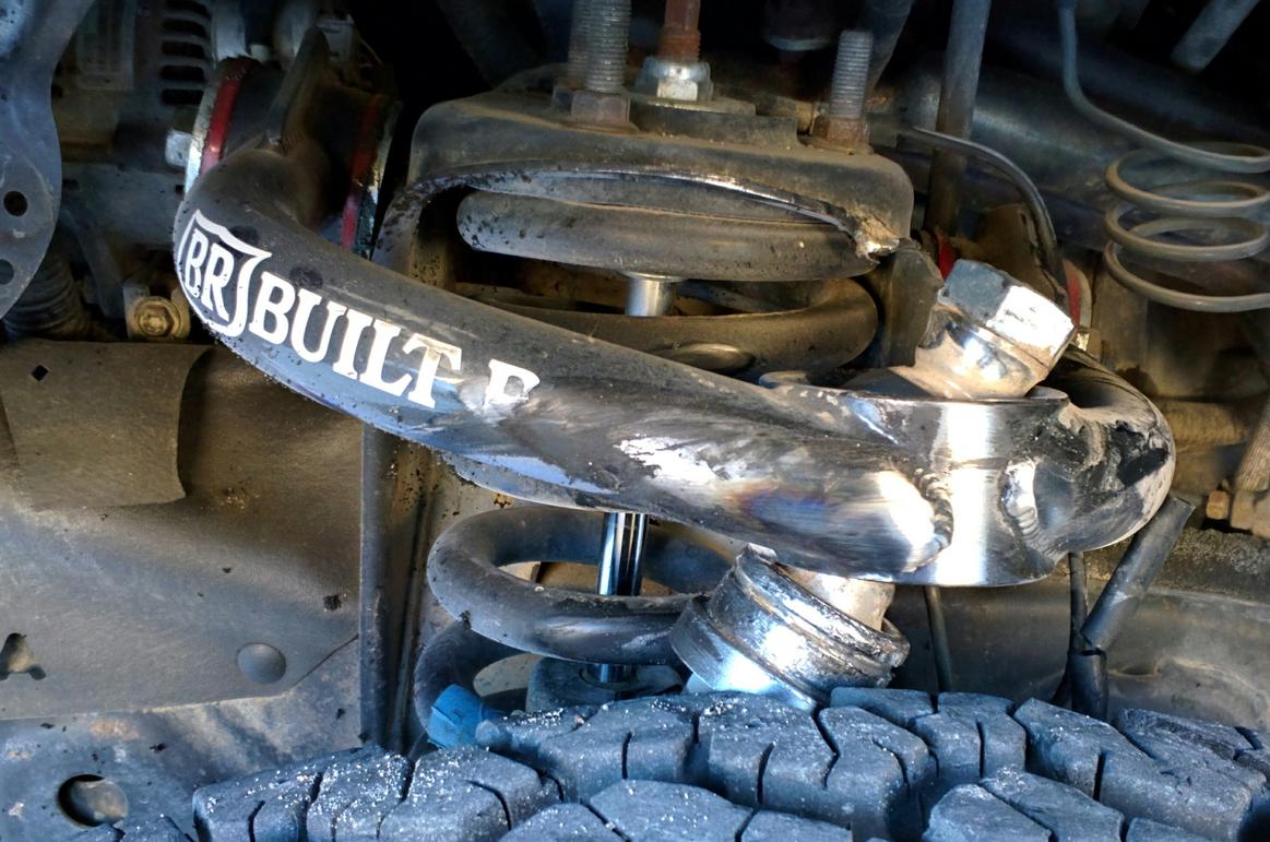

This is what broke apart. The doughnut hole at the top split apart. At first I thought it was the Built Right UCA that failed but closer inspection shows it was this part. The ring split apare and the UBJ fell out.

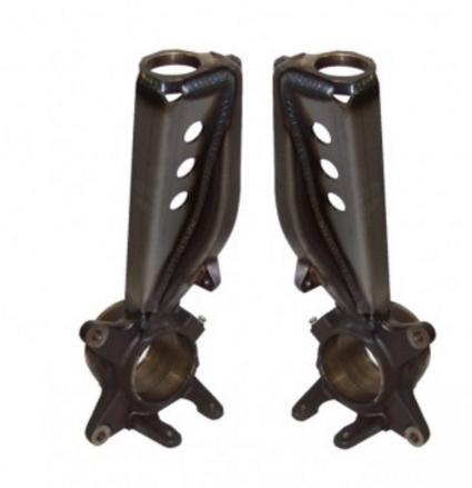

Aww makes sense. I knew you had upgraded upper control arms. Just last week I was looking at the total chaos spindle support you weld in, I push my car pretty hard, will be ordering it soon now.
Spindle support?
I did not know about this but I will definitely be buying these. I recommend EVERYONE get them added if you do offroading. To think a $40 part MIGHT have prevented what ended up costing me a whole day and several hundred dollars (could have been thousands with rescue services pricing) is very frustrating.
Total Chaos 59697 WELD-ON SPINDLE GUSSETS for 3rd Gen 4Runner

That's it!!!
I just ordered it earlier just need to have them welded in once they arrive.
Also solo motorsports in West Covina has whole spindles already upgraded.
I don't think it would have been an easy trail fix. The only way I could think of it working would be to weld the bolt from the uniball directly to the spindle. One of the Tundra guys did have a welder with him. But, if it did hold, it would have only gotten you to the pavement. So you would of still needed the trailer, and if you stayed and tried to fix it, you would of lost your opportunity to get a trailer that day.Those spindle gussets keep the spindle from bending, but I don't see any reinforcements done to the bolt hole where yours broke. I'm wondering if that hard impact from the day before possible cracked the spindle, and cottonwood just finished it off. It also looked like you'll need a new abs wire. I'm glad you made it out. Sometimes when things go terrible wrong it just adds to the adventure, and it will be a great story to tell for the rest of your life.

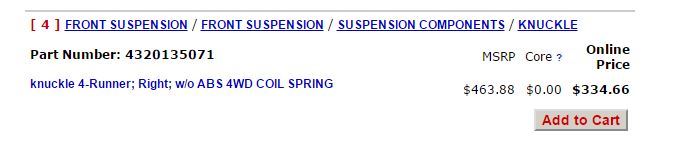

Can I use a used part for the hub that holds in the wheel bearing and the UBJ spindle? I don't see why I should pay $350 for a new part.

Regarding the Spindle support, I head about this and was considering them. However, how would would these gussets help in your situation Brian, it sounds like the the control arm bolt came lose from the spindle housing, correct? Or did your spindle snap?

Not sure on the installed price but they are 1,700 a pair. Fully
Customized and definitely would of prevented this failure.
Here's a link to the page
Toyota Fully Fabricated Spindles | Solo Motorsports
The TOYOTA spindle is $50 at a junk yard and the beefing it up adapter from TC is only $36.
Much more affordable. It sounds like I'm finally going to be getting my front wheel bearings changed.
Mechanic says I'm looking at around $750 + tax for replacing wheel bearings + seals and the beefed up adapters and welding them on both sides. A lot of it is the labor from disassembling each side, replacing the seals, adding the adapters ect, putting it all together.

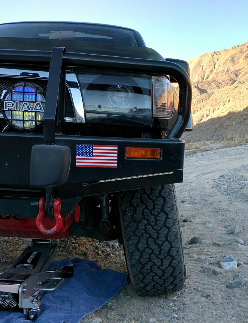

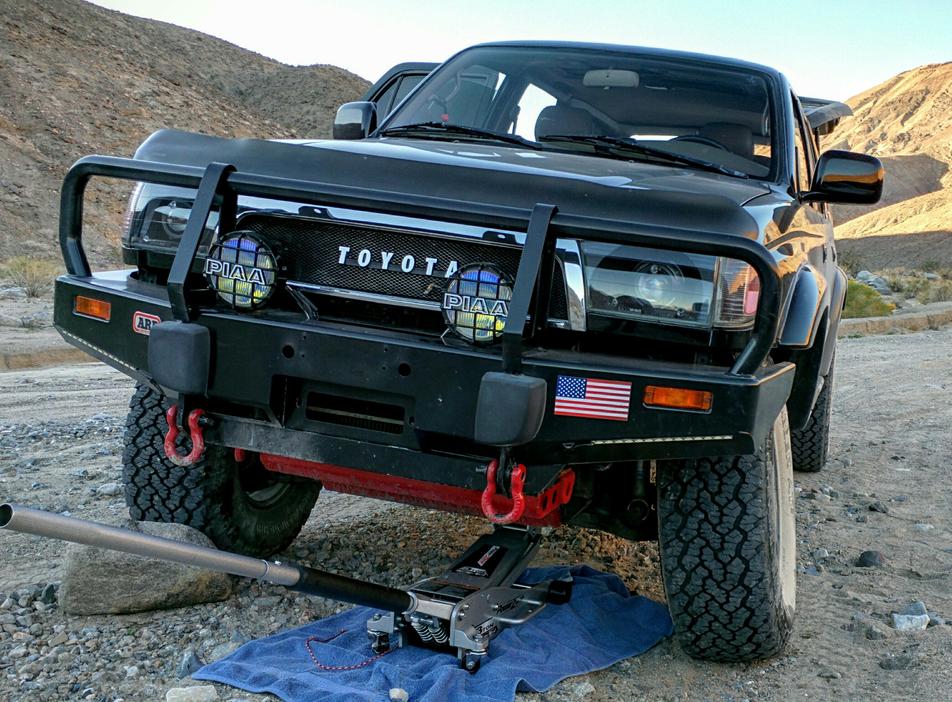

Here are the pics ...
See the jack. What a life saver. I cannot begin to express how glad I am that I finally started carrying this floor jack with me on trips instead of the high lift jack. This is so much easier and safer to use.

The jack was wrapped in the towel and strapped down in the back of the 4Runner. A loose jack will kill you in an accident.
