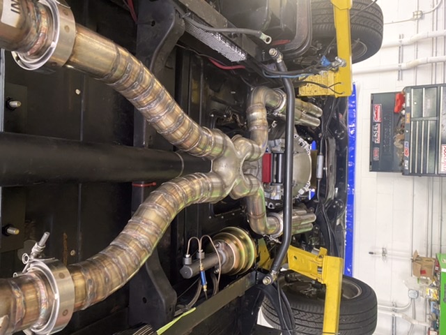

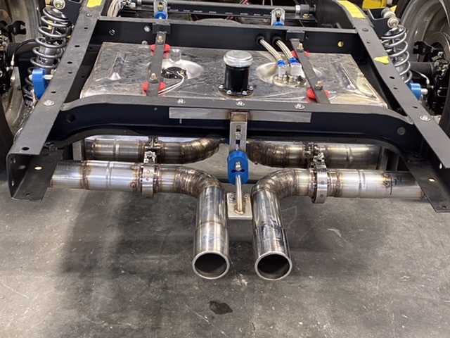

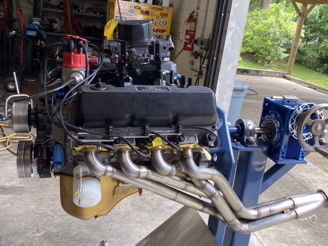

Welding
Learning to weld opened up a whole new world for me. I only tig because I like the control and the beauty of the welds. You will not regret it.

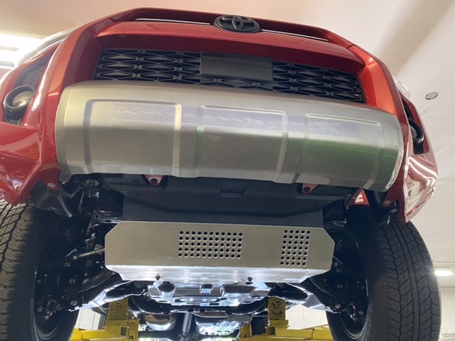

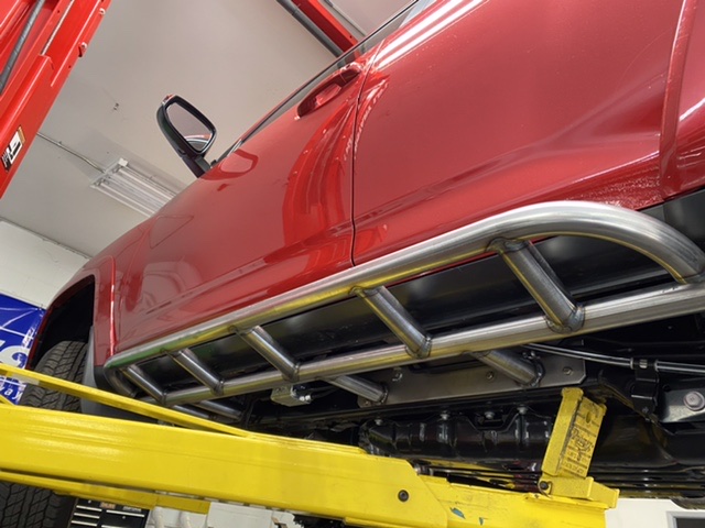

Toyota related
Made these for the 4RUNNER
