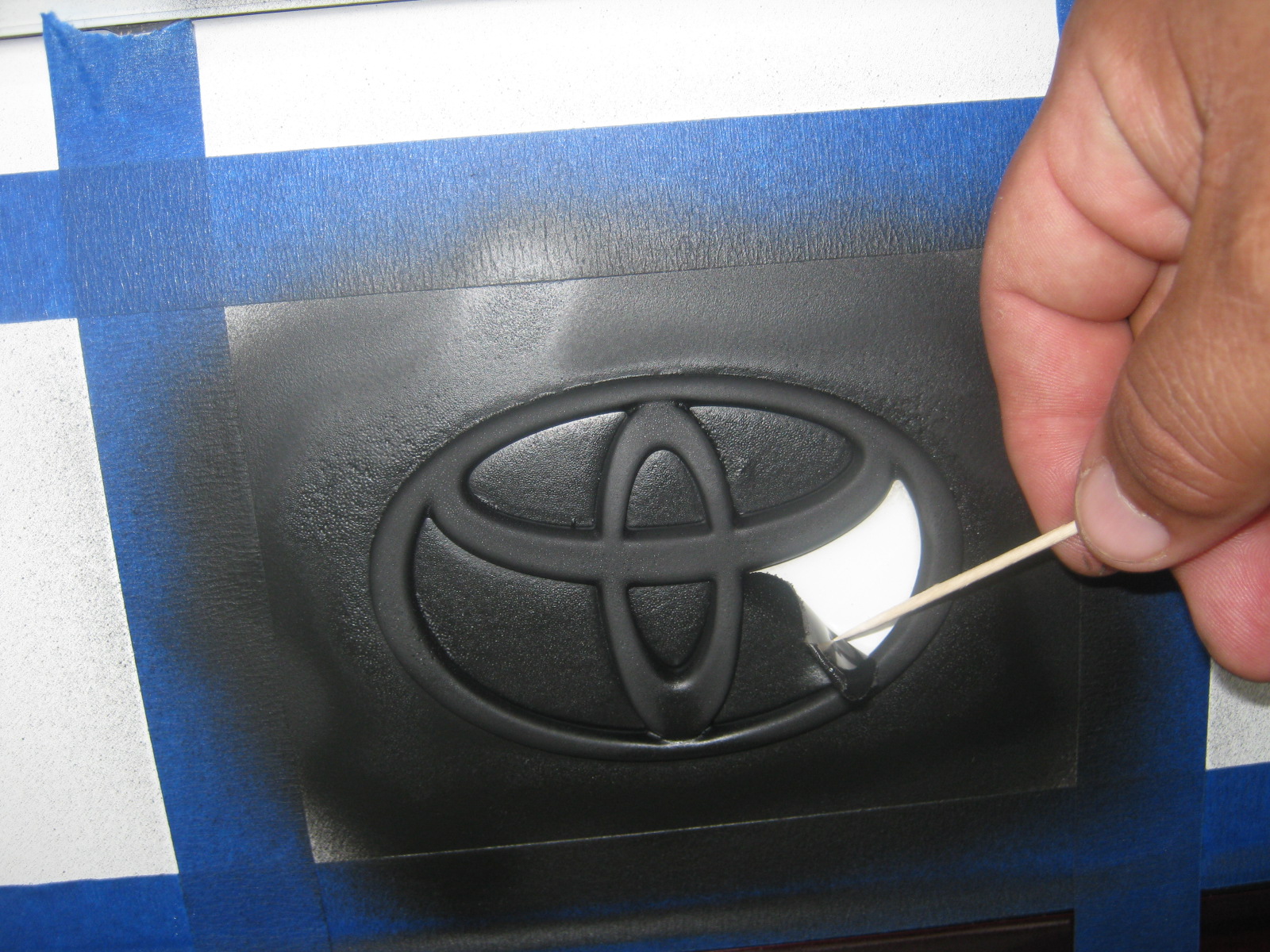

That’s the beauty of PlastiDip, all you have to mask is a rectangle around the badge. Then you peel the ‘Dip and it comes off except for what’s on the letters or emblem. Not my pic but to illustrate:

What Bluesky said...you don't even need to be that close with the masking. It pulls off in a rubber sheet. Put down at least 5 coats, let them dry, grab a corner and peel. This was on my old Tacoma and lasted without an issue for years. Snow, salt, pressure washers...Plastidip is incredibly durable.
