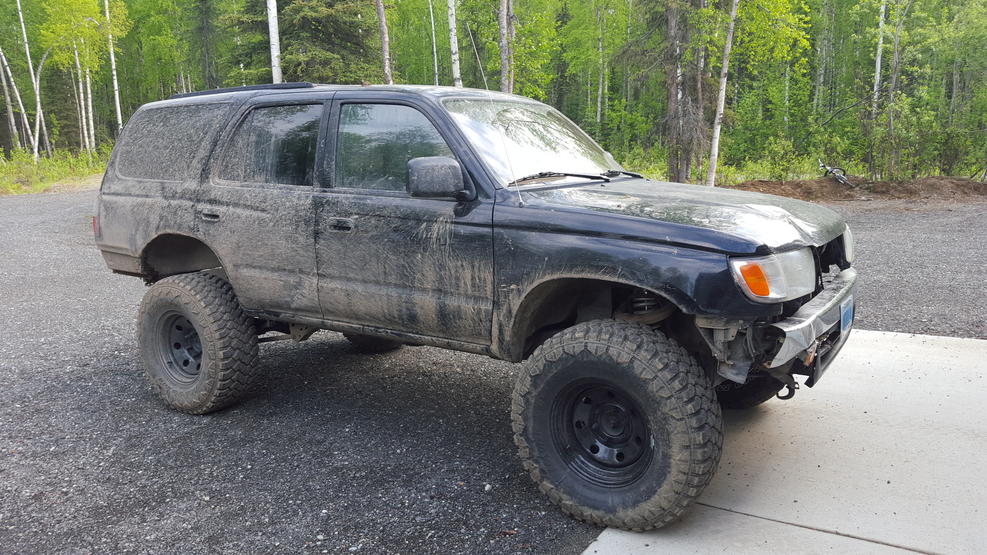

Really hard to go wrong with the Toytec 3" Bilstein kit. Yeah the coil over would be nice, but that's a lot of extra coin for some added adjustability that you will likely set once and not mess with again. I added the superflex rears for just a few extra bucks. While I know some don't like it, I like the rake and it will disappear as I add my rear bumper and tire carrier. Plenty of room for 285's and bigger if you like using sawzalls and hammers :)
