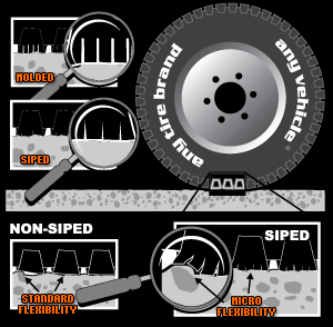

A sipe is simply a small groove or cut in the tread. The more sipes you have, the better your vehicle will go in snow and ice. Why? Because as your tires make contact with the ground, the tread deforms a bit. If you have lots of small grooves in the tread then each one of the edges of the sipe will deform and act like miniature cleats that will give you better traction. That, combined with a soft tire compound will allow even more tread deformity when it contacts the ground which will give you even better traction. Add to that a lower tire pressure and now you have the best situation you can have with the exception of studs or chains.
The only real problem of running a high siped and soft tire is wear. These tires will only get about 20K miles before needing to be replaced, hence that is why they are mostly winter tires only. A good AT tire attempts to bridge this gap by offering some siping, a decent tread block and a medium tire compound. Hope this helps. Oh, here's a pic to help with my explanation:

Thanks Greg,
I appreciate the explanation.
