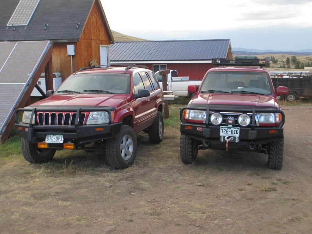

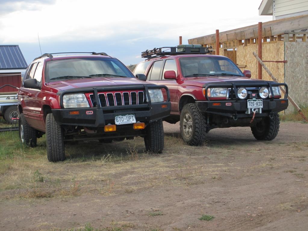

IMG_1616 (1024x768).jpg The ARB on the 4runner is untested but the one on the GC has stopped two deer and one Subaru that was driven by a dog in a parking lot . One of the deer was a large buck at 60 mph and I had to replace a mounting bracket . Not bad. As far as I know ARB is the only one that is air bag compatible.
