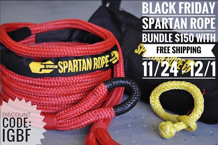

if you are looking for a kinetic strap consider Spartan Rope.
They have a great product and outstanding customer service.
They are local to me and delivered it personally.
@greathim mentioned these guys to me.
Several guys I know use them
https://www.spartanrope.com/
scored mine cheap on black friday
used mine a couple of times over the winter, worked as it should and great value for the $$..
