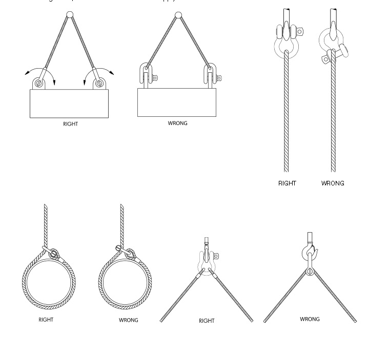

While we're talking recovery, a few safety points...
When using a hook always hook from the bottom up so that if the hook break it's driven down into the ground and not up into the air.
Also when shackling, here's proper way to saddle a dead horse... (I keep a laminated copy in my gear bag just in case I forget)

Thanks for the illustrations. I have my bridle connected wrong according to the drawings. I just don't see another way to attach the shackle without getting the shackle nut buckling into the bumper. See my photos in my thread about How To Make A Bridle. Comments on what I show would be welcomed.

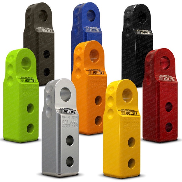

Cancel that Chinese pot metal and get yourself the real deal Factor 55 Hitchlink, CNC machined 6000 series aluminum, made in the USA.

Its been a while but this is a too good thread to die.
[MENTION=116607]CharlestonFisher[/MENTION] Do you own a Factor 55 Hitchlink yourself? I am hesitating between the Smittybilt S/B29312B which come with a shackle and a Factor 55. My main concern is using a BubbaRope Gator Jaw directly to the Hitchlink. Are the edges of the Hitchlink too square to prevent damage or failure of the Gator Jaw?

I've recovered the runner out of snow a few times with a cheap hitch receiver and even cheaper, auto parts store grade tow strap and steel shackles. Really guys, it not like we're trying to pull a bus uphill.
Some of you take the brand/make of shackles and other recovery gear way too seriously. Guess what, I use Chinese recovery boards too and they work like a charm.
