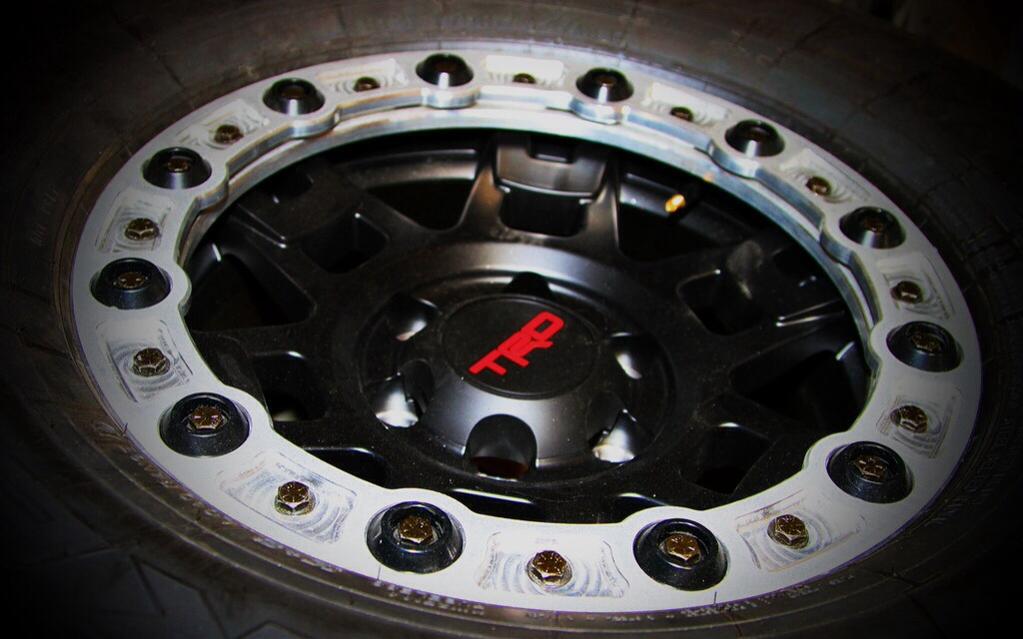

For wheels we love factory wheels, the guys over at TRD hooked us up with these TRD 4runner wheels. But we couldn't leave well enough alone so we called up the guys over at OMF and said make these sexy wheels sexier. That's like asking a plastic surgeon to make Kate upton hotter? who does that? Well we did and they delivered! I hope you guys like them too!

Just in case anybody is wondering , the wheels are 330$ plus cost of the wheel
