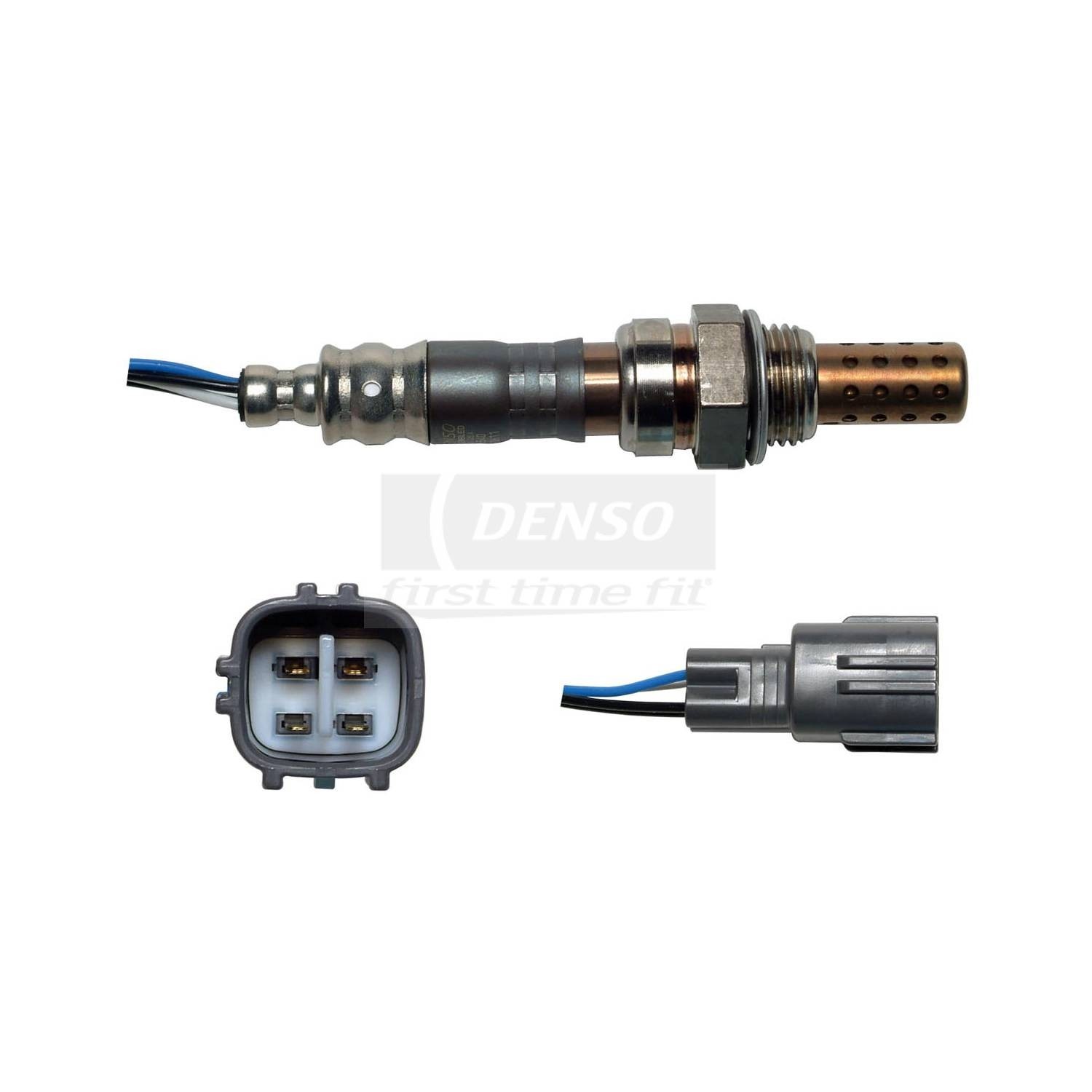

Denso O2 sensors any good?
They are a hell of a lot cheaper than Toyota, am hoping I can use these instead!

The 2002 (and maybe 2001) have the hex plug sensor type that needs the socket. Earlier years all have the flange type shown in the write-ups.

The 2002 and 2001 have the hex plug sensor type on the downstream sensor that needs the socket. Earlier years all have the flange type shown in the write-ups.
2001-2 takes 234-4261 downstream:
If you live in the salt belt, you probably will need new nuts for the flange type. Part No. 90179-08059 or any stainless M8-1.25 will do.

Let me see if I get this straight, the one I want to replace is the one in front of the Cat and that one has a flange and it is 234-9002.
Only need to replace the one after the Cat if it throws a code and that one does not have a flange and is part number 234-4261?

Then don't replace it. Like Brian, it doesn't actually do anything other than throw codes. It is 100% waste of money until it is throwing a code.
