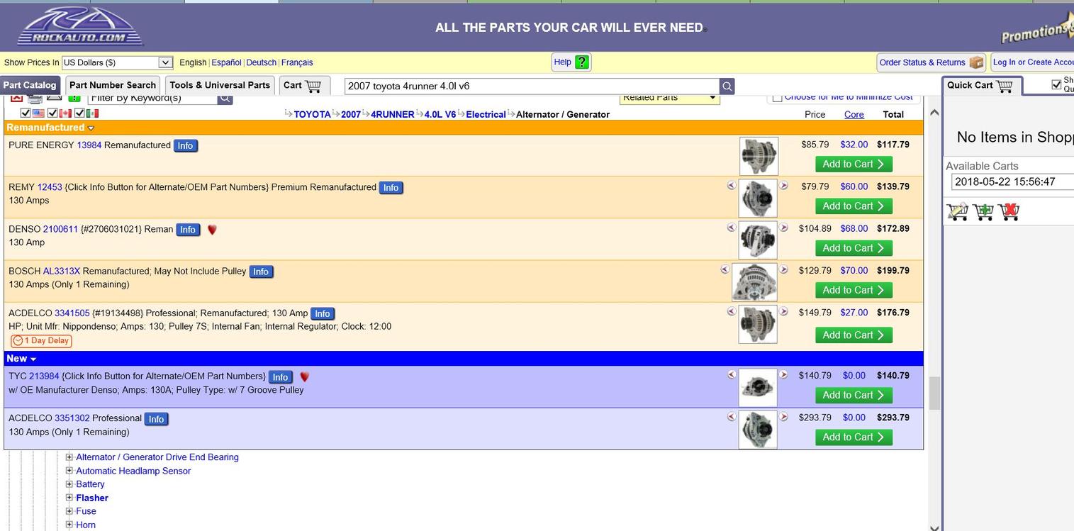

Rock Auto lists several. The upper $ range are Bosch and AC Delco, all are reman except for one new AC Delco.
also I really don't want to do any rewiring - just plug and play

how much electrical accessory have you add? planing to add more? a high output alternator is the way to go if you have a large load. but for oem replacement , try the junk yard if you want, then take the old worn one out and have it rebuild to output a little more.
I agree with the high output if you need it, but if I was going to order from Rock Auto looking for an OE replacement I would get that reman Denso.

It looks like all the current choices are 130. I had read somewhere here that the original for the generation was 100. I need to look at the one on my truck now and see what the part num is. But, I guess I am leaning toward the Denso, it just looks like there may be several, if not many, re-builders of Denso units and the result is mixed - some good, some fatally bad.
