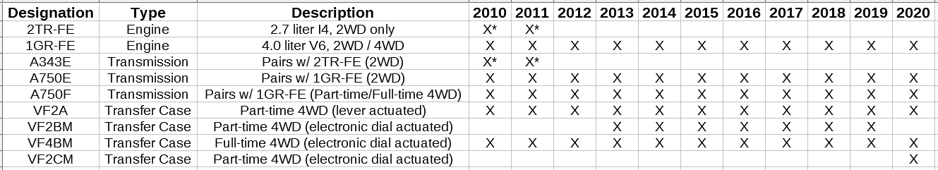

Automatic Transmission:
Designation: A750F

Axle:
Designation: A01A
Transfer Case (Part-Time 4X4 w/ Electronic Dial):
Designation: VF2BM (Toyota part #: 3611035521)

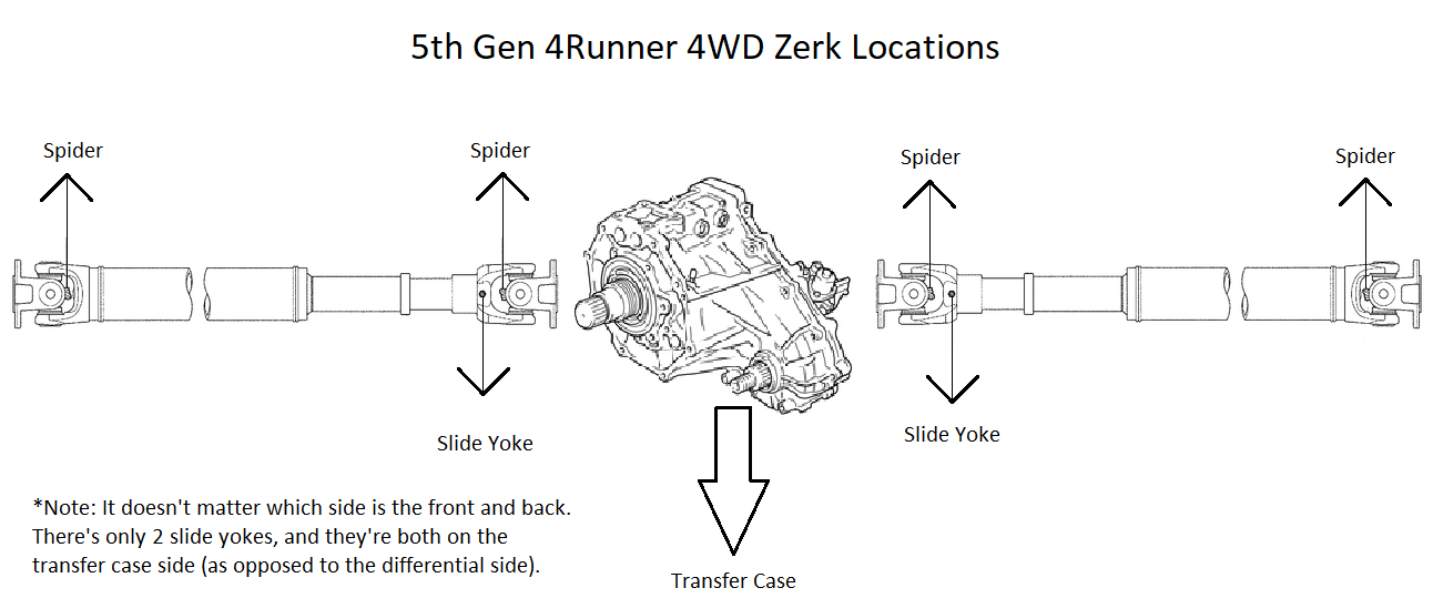

Drive Shaft:
Fluid Change Interval: 15,000 miles / every year – whichever comes first
* for hard use (towing/loading): 7,500 miles / 6 months – whichever comes first;
*deep mud/water: As soon as you get back from off-roading.
Toyota Fluid: N/A
Preferred Fluid: (listed below)
Spider Grease: Classification: Lithium base chassis grease, NLGI No. 2
(Preferred: Lucas Oil Red 'N' Tacky #2 (10005))
(Good Alternative: Mobil 1 Synthetic Grease (105527))
Slip Yoke Grease: Classification: Molybdenum-disulfide lithium base chassis grease, NLGI No. 2
- OR -
(Preferred Grease: Mobilgrease XHP 322 Mine)
(Good Alternative: Valvoline Moly-Fortified Gray Full Synthetic Grease (VV985))
Capacity:
Spider Joints: Pump in new grease until old grease oozes out of the seal.
Slip Yoke Joints: There is conflicting information on this subject and I was unable to find anything official.
The safe bet is to pump 2 - 3 pumps of grease from a pistol grip grease gun.
Preferred Grease Gun: LockNLube Professional Pistol-Grip Grease Gun (LNL252)
Good Alternative Grease Gun: Lincoln 1134
Spider Zerk Fitting: Toyota part #: 9041606004 (socket size: 7mm)
Slide Yoke Zerk Fitting: Toyota part #: 9645100600 (socket size: 7mm)
Propeller Shaft Bolt: Toyota part #: 90105A0075 (socket size: 17mm; torque: 65 ft·lbf)
Propeller Shaft Washer: Toyota part #: 9020111013
Propeller Shaft Nut: Toyota part #: 90178A0045 (socket size: 14mm)
<a href="https://youtu.be/JdxHjbjICWs" style="color: blue" target="_blank">DIY: How to Lubricate the Propeller Shaft on a 2016 4Runner Trail</a>

Transmission:
Designation: A750F
Fluid: Genuine Toyota Automatic Transmission Fluid-WS (Toyota part #: 00289ATFWS)
Capacity: 12 quarts (pan=1.8; valve body=4.5; torque converter=5.7)
Check/Overflow Plug: Toyota part #: 9034110021 (15 ft-lbs)
~ TRANSMISSION CASE ADAPTER REFILL PLUG (official name) ~
Fill Plug: Toyota part #: 9034118059 (27 ft-lbs)
Fill Plug Gasket: Toyota part #: 9030115004
Drain Plug: Toyota part #: 9034110011 (15 ft-lbs)
Drain Plug Gasket: Toyota part #: 3517830010
Automatic Transmission Oil Pan: Toyota part #: 351060C010
Oil Pan Bolts (20): Toyota part #: 90119A0298 (62 INCH-lbs)
Automatic Transmission Oil Pan Gasket: Toyota part #: 3516860010
Transmission Filter: Toyota part #: 3533060050
Transmission Filter Bolts (4): Toyota part #: 9008011273 (7 ft-lbs)
Automatic Transmission Oil Pan Magnets (4): Toyota part #: 3539408010
Axle:
Designation: A01A
Fluid: Toyota SAE LF 75W (Toyota part #: 0888581080)
Capacity: 1.1 quarts (part time); 1.5 quarts (full time)

Drive Shaft:
Spider Grease: Lithium base chassis grease, NLGI No. 2
Slip Yoke Grease: Molybdenum-disulfide lithium base chassis grease, NLGI No. 2
Preferred Grease: Valvoline Moly-Fortified Gray Full Synthetic Grease (VV985)
Good Alternative: Mobilgrease XHP 222 Special / Mobilgrease XHP 322
Capacity:
The safe bet is to pump exactly 3 pumps of grease from a pistol grip grease gun.
