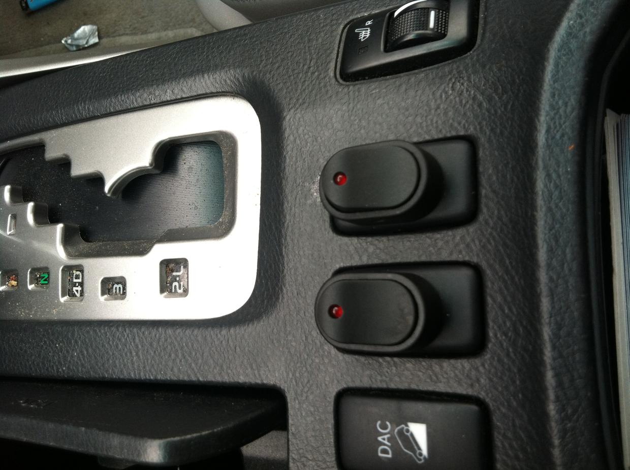

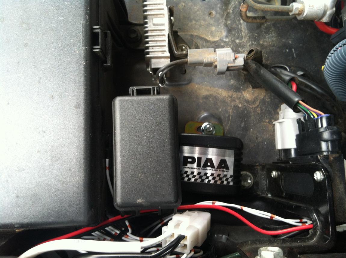

First thing I did was install the new PIAA Lights. I'm used to having to make my own wiring harness so the PIAA kit was a nice change, although I thought the switch that came with it was pretty useless so I opted to replace it with a backlit rocker.
I also found a convenient place to locate the relay with a predrilled hole at the top of the driver fender next to the fuse block. This was the perfect place to put the relay with the pre-length wiring harness.

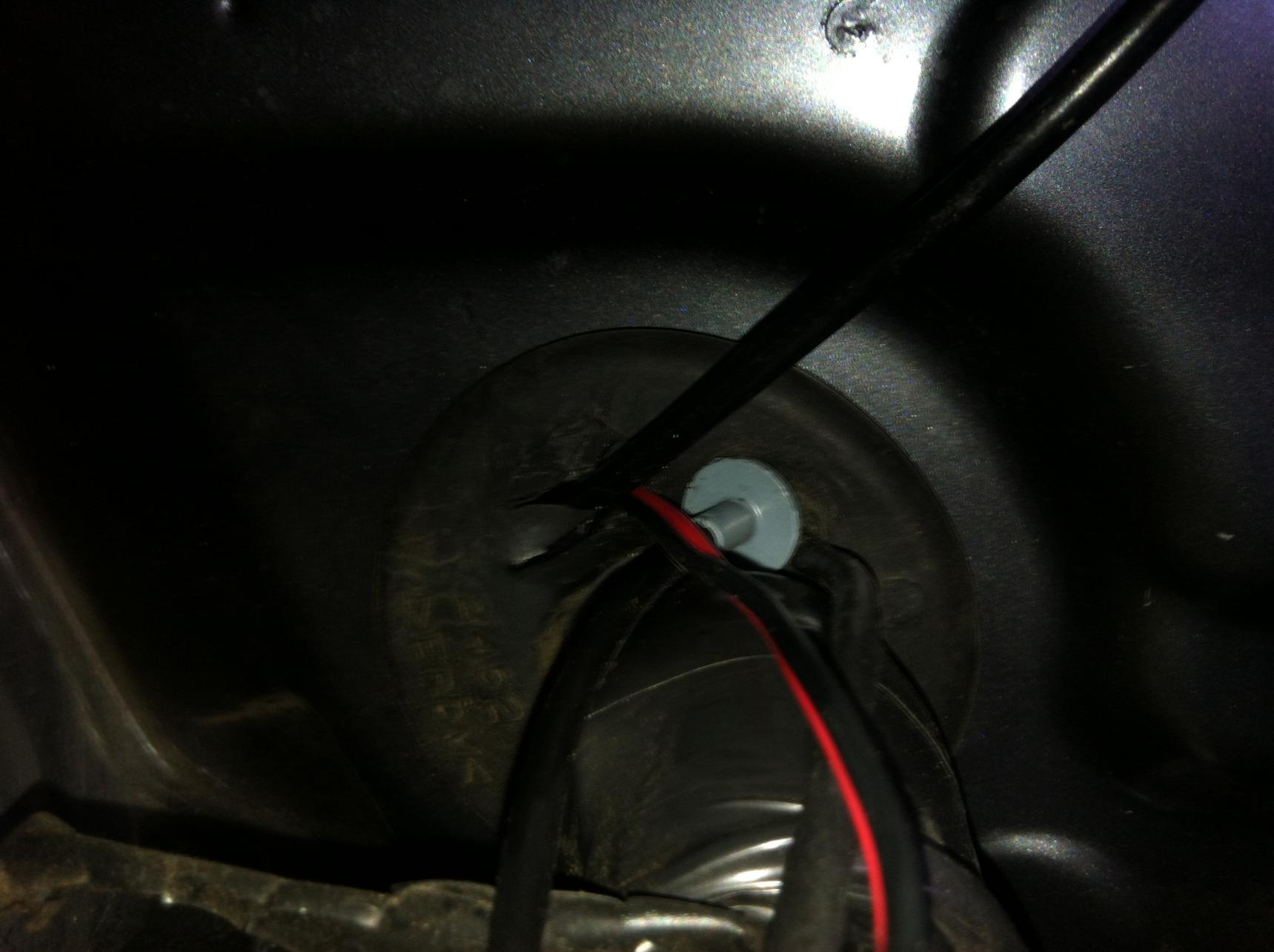

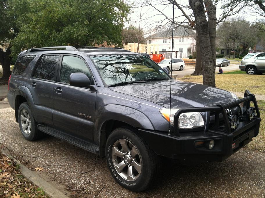

The CB was a little more difficult. In order to attach the antenna I had to detach the fender liner from the passenger front side of the bull bar and work my arm up there under the mount hole. IF YOU PLAN ON PUTTING AN ANTENNA ON YOUR BULL BAR DO IT BEFORE INSTALLING, at least the mount part. I ran the cable up along the fire wall and then came the most difficult part of the day and that was running the coaxial through the fire wall. I did this by cutting an "X" in the driver side grommet and then pushing a screw driver through with some tension. This showed me a straight line of where the cable would run and pushed out the other side of the grommet making a good guide for where to cut the "X" on the other side. (much like trying to push your finger through the outside of a deflated balloon). After that, a little cooking oil on the finger to lube up the grommet and the cable went straight through.

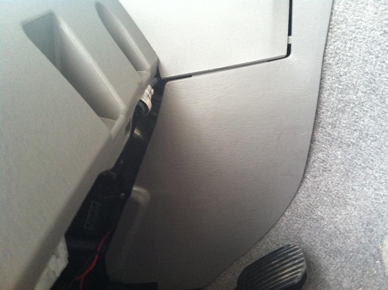

I placed the box for the CB behind the center console next to the gas pedal. The plastic pops right off and the box slips nicely in there. This also made for a very clean install for the mic plug which keeps it completely out of site when not in use. There is no way to drill here to ground the box, so I ran another ground wire from the box to the fire wall to ground the unit.
If you look very closely you can see the mic plug at the very bottom of the dash.
After installing the CB I took it to Bonnie and Clydes here in Dallas for a tune. Turns out the 3' firestik I bought was too short, they replaced it with a 4' K40 and I was tuned and on my way in about an hour.

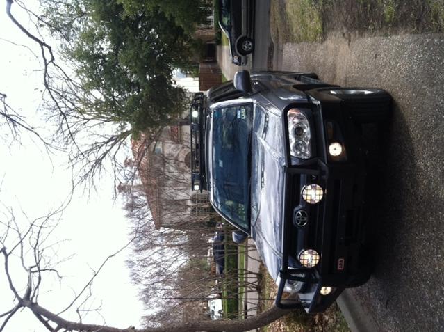

Any chance you can take some more pics of the ARB bumper? Ideally a photo from the driver seat looking out, I'd like to see what it would be like driving with this bumper.
Certainly. How tall are you so that I can get the most accurat perspective?
Sorry some of these pics turned out awkward in their orientation. I promise they were set correctly before uploading.

it looks bad ass. You can see the entire top bar across all three hoops.
