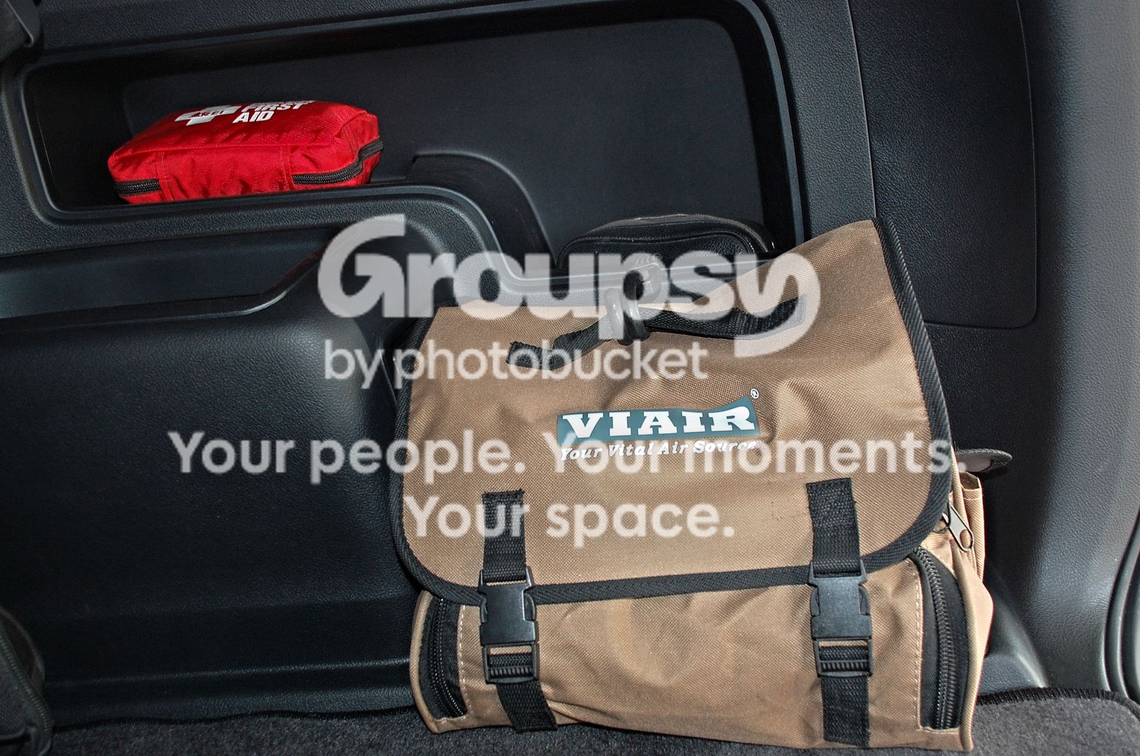

So I purchased a tire repair kit and picked up a VIAIR 400P portable air compressor that delivers 2.54 CFM and good up to 150 PSI max. pressure with 40 mins. of continuous use. The unit is mounted on an anti-vibration tray and includes direct heavy-duty dual battery clamps with 40-amp inline fuse.
The system also comes with quick disconnect air hose and tire gun with 200 PSI gauge, and assorted accessories, all contained in a nice storage bag with additional pockets.

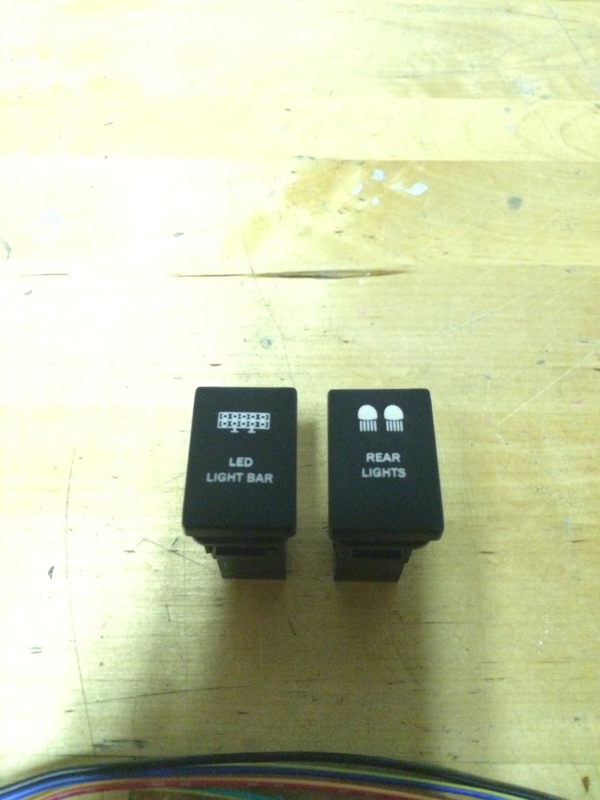

For switches I bought these from a site called Air On Board. They fit in the existing holes in your dash and even match the illumination. The site must have problems keeping them in stock, however, because they seem to run out quite often.

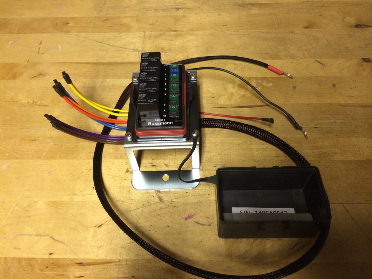

I also found a really nice Fused Relay terminal that several members on here have used. The guy that builds them does an awesome job.

Thanks [MENTION=101352]harkco[/MENTION]! I checked out the Air On Board site and your're right in that those switches are not in stock. I guess I could order the "zombie" lights for my roof LED light bar but kind of hokey...although I do love to watch "The Walking Dead"...lol.
I will have to look into that fused relay terminal; really slick setup as I might add some rear lights as well. Thanks again!
