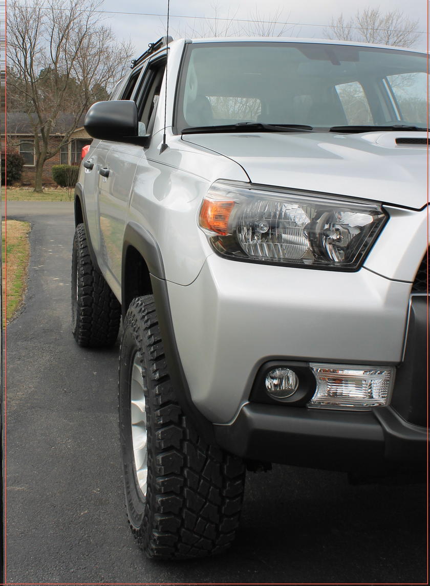

I just got these tires about 2 months ago. I have a tundra as well as the 4runner. I was in the same boat as you trying to decide. I have Duratracs on my tundra now for about 2years/25k miles. They're awesome offroad and pretty squishy on road if you hit some uneven pavement they are kinda scary. I also have had two sidewall punctures that i have luckily been able to fix. They were not loud at first but as they wear more and more they begin sound like i have mud tires. All in all i havn't been too impressed with them.
So like you not really wanting a mud tire i went with st maxx. They shed mud really well, couldn't ask for a better offroad tire in my opinion. I would say they are on par with the duratrac offroad. On road they barely hum, very quiet as aggressive as they are and much more stable feeling than the dt's. The sidewalls are much much tougher then the duratracs granted the maxx's are an "E" rated tired. My only gripe is they are very heavy i think about 65lbs for 33's and they do like to pick up rocks.
I will be replacing tires on my tundra soon with 35'' st maxx's.
Wow...great input KTMRIDER, and love the pic...thanks! Those do look good; however, was curious if you had any side shots as well? If not, no worries as I do appreciate that close up of the tread.
I guess I didn't have the Duratracs long enough to experience the noise issue as mine only about 12K miles on them, but good to know for future reference.
I agree that the Cooper MAXX is a pretty heavy tire considering it's far from the most aggressive looking. I mean, even the BFG KM2s which is a full MT weighs in at 59 lbs. for the LT285/70R17 versus the 61 lbs. Coopers of the same size. But I rather have the confidence and performance of the E rated tire with stiffer sidewalls.
Thanks again for posting!
